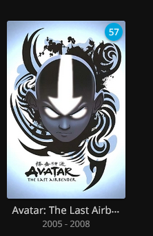

Number of episodes on banner:
[Image: 1.png]

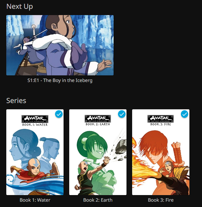

Episode in next up, but empty seasons:
[Image: 2.png]

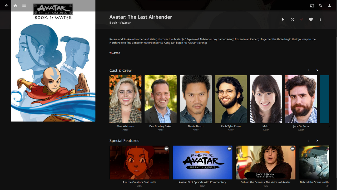

Everything but episodes on season page:
[Image: 3.png]

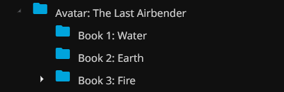

Empty season in metadata manager:
[Image: 4.png]
