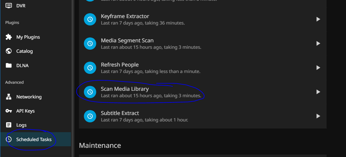

RE: Library Scan - Jedich - 2025-04-01
Nope, even the new Shedule doesn't work:
[Image: 1.png]
