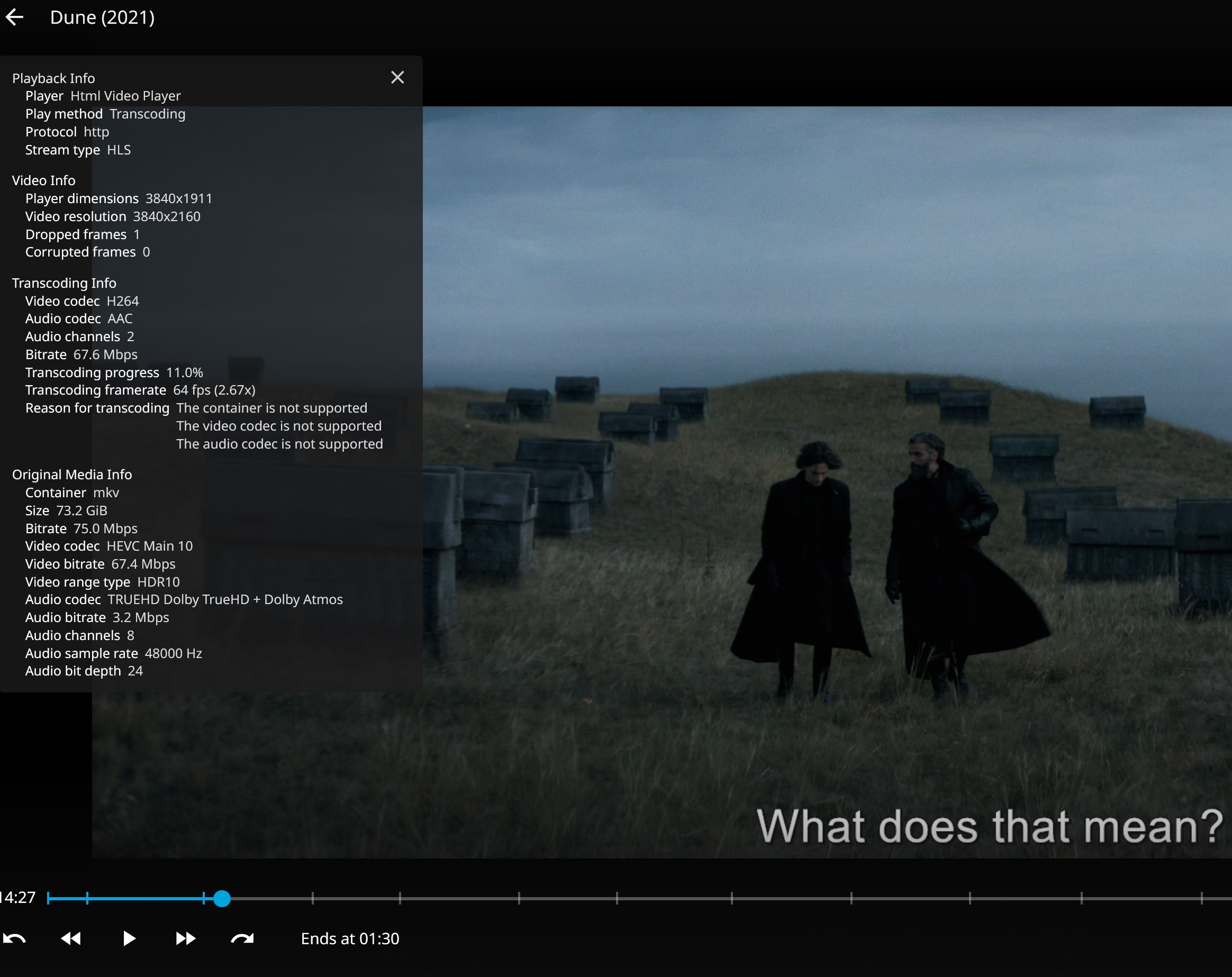

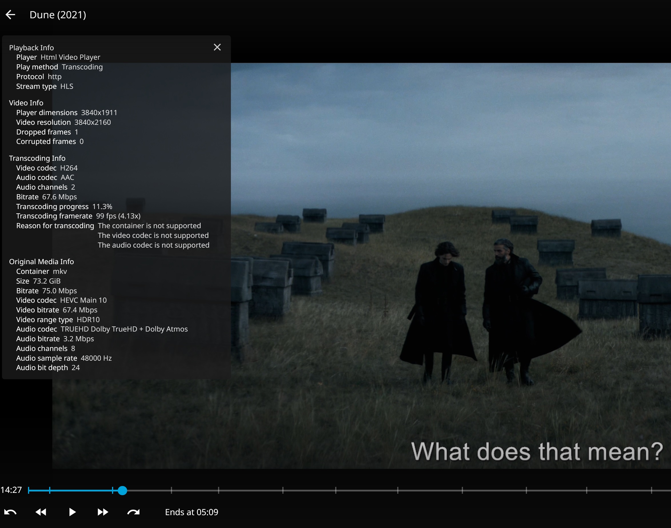

frame= 4586 fps= 80 q=24.0 size=N/A time=00:03:10.52 bitrate=N/A speed=3.34x
For comparison, this is Dune (2021) transcoding on an intel i5-11600k (UHD 750) and a Xeon 6244 with an intel ARC A310:

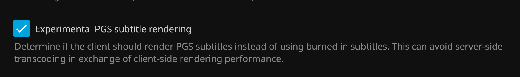

But burning in subtitles also have a cost to performance, so I'd suggest you try enabling the experimental PGS rendering under client settings.
