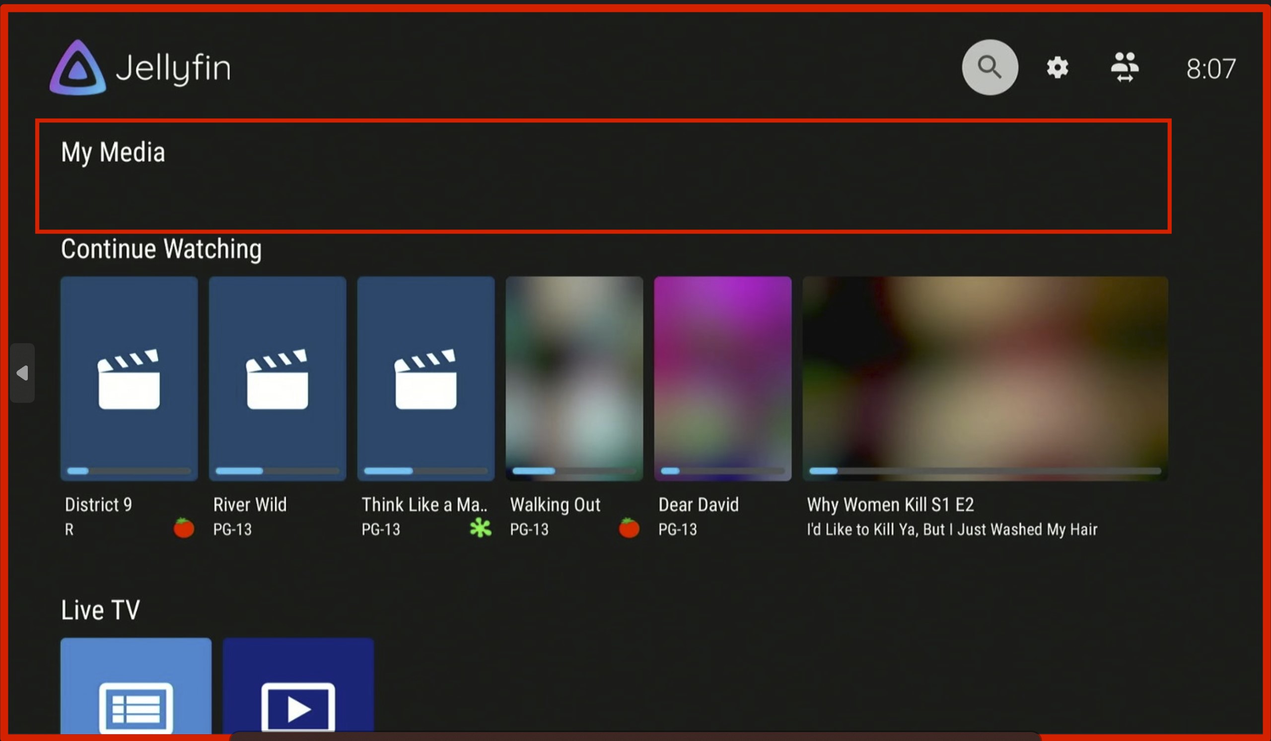

| Firestick Firmware 8.1.0.1 issue - playbyplay - 2023-11-21 Can someone point me in the right direction? I bought a new Fire TV Max 4k stick and after downloading the latest Jellyfin app from the Amazon App store, all my media tiles/folders are missing. The picture attached show what little appears. My Jellyfin works on my other devices just fine. Its only Firesticks doing this. So far on two Firesticks. Even more strange, my Toshiba Fire TV Edition works great with the Jellyfin app. Specs below. Not working Firestick Firmware: Fire OS 8.1.0.1   Jellyfin App Version: 0.15.12 Jellyfin dashboard Version: 10.8.11 Working Toshiba Fire TV Firmware: Fire OS 7.6.6.4   Jellyfin App Version: 0.15.12 Jellyfin panel Version: 10.8.11 RE: Firestick Firmware 8.1.0.1 issue - tmsrxzar - 2023-11-21 app 0.15.12 (from amazon store) / Fire OS 7.6.6.4 also works fine for me i looked into a few settings but i don't actually see anything that should break the My Media section (ways to hide it completely but not be empty) unless someone else has an idea i would recommend opening a new issue on github for this (i didn't immediately find one already open) https://github.com/jellyfin/jellyfin-androidtv/issues RE: Firestick Firmware 8.1.0.1 issue - playbyplay - 2023-11-21 tmsrxzar dateline='[url=tel:1700583773' Wrote: 1700583773[/url]'] Yea it is the latest Fire OS update that is messing Jellyfin up. All my devices with OS 8.1.0.1 has the issue but all my devices running 7.6.6.4 are still good. Recommend not updating Amazon Firmware until Jellyfin does a fix. |
