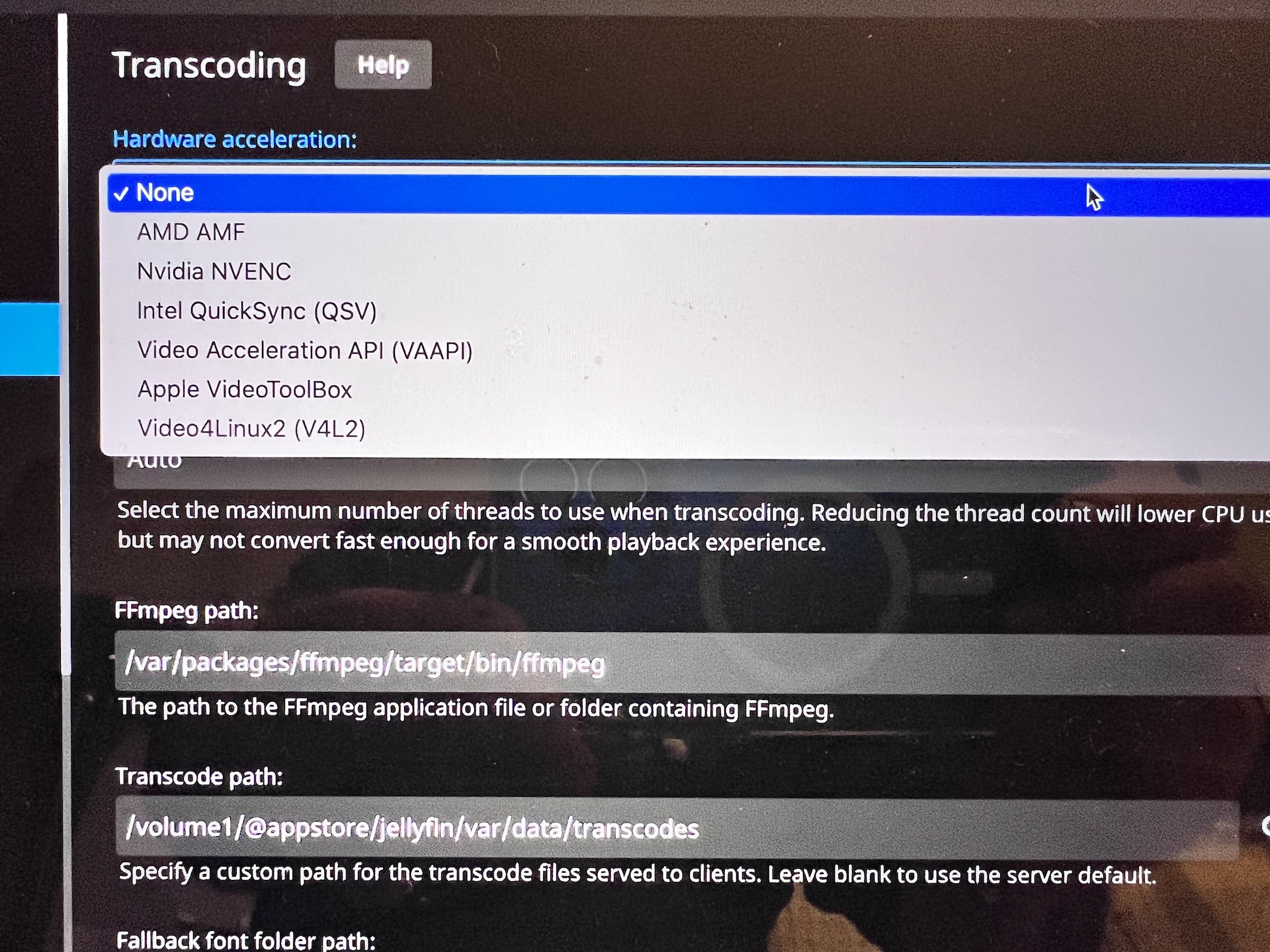

Installed Jellyfin for the first time on my 1019+ directly from the community packages (not Docker).
Started setting up the server and was asked which config mode the hardware acceleration should be used? I'm not sure so I ask, anyone familiar with this setting?

Your NAS has an Intel J3455 so you would select Quick Sync.
Use this table to help you check the appropriate boxes. The Apollo Lake column.

Ok synology is working fine,
My second TV has an nvidia shield 2019 and the acceleration doesn't seem to work after seleting the nvidia. video playback is choppy snd skipping foraward stops playback.
Anything i should select differently?
TY
RE: Synology Hardware selection - TheDreadPirate - 2023-12-24
What do you mean by "selecting the Nvidia"? You selected NVENC for hardware acceleration? That option is for what your server can do. Not the client.
