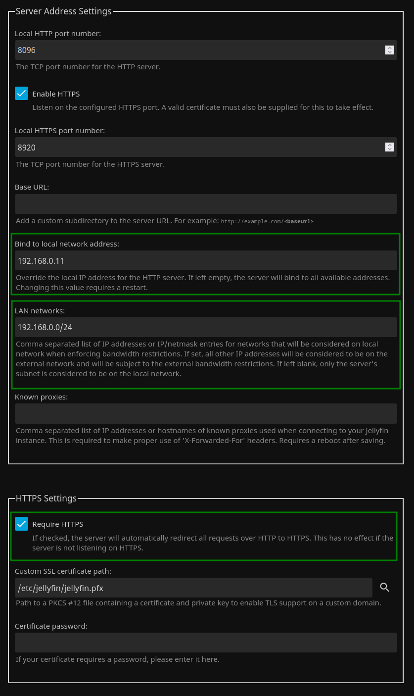

RE: Native https access - ro55mo - 2024-02-04
So I just thought to try checking the 'Require HTTPS' setting now no errors were appearing about the pfx in the log. I also tweaked a couple of other settings.
After restarting the server again it kicked into life.
ss -tup
Netid            State            Recv-Q            Send-Q                      Local Address:Port                        Peer Address:Port            Process
tcp              ESTAB            0                0                            192.168.0.11:793                          192.168.0.10:nfs
tcp              ESTAB            0                0                            192.168.0.11:8096                        192.168.0.25:56240
tcp              ESTAB            0                0                            192.168.0.11:22                            192.168.0.25:43956
tcp              ESTAB            0                0                            192.168.0.11:22                            192.168.0.25:40928
tcp              ESTAB            0                0                            192.168.0.11:8920                        192.168.0.25:40698
tcp              ESTAB            0                0                            192.168.0.11:8096                        192.168.0.25:58180
tcp              ESTAB            0                0                            192.168.0.11:8096                        192.168.0.25:56202
tcp              ESTAB            0                0                            192.168.0.11:8096                        192.168.0.25:58176
tcp              ESTAB            0                0                            192.168.0.11:8096                        192.168.0.25:58172
tcp              ESTAB            0                0                            192.168.0.11:22                            192.168.0.25:56334
tcp              ESTAB            0                0                            192.168.0.11:8920                        192.168.0.25:46234
tcp              ESTAB            0                0                            192.168.0.11:8096                        192.168.0.25:56224
The setting 'Require HTTPS' says 'If checked, the server will automatically redirect all requests over HTTP to HTTPS. This has no effect if the server is not listening on HTTPS.'
This does not seem to be happening right now. I can still open pages on 8096 and no redirection happens. It does work if I open an in-private browser session. Cached session of some type I guess.
Thank you for pointing me in the right direction. It would have been very helpful if the Jellyfin web GUI could have displayed any errors relating to the certificate though.
Expected behaviour from my point of view would be for https on 8920 to appear when 'Enable HTTPS' is checked and a valid cert is present, not 'Require HTTPS'.
