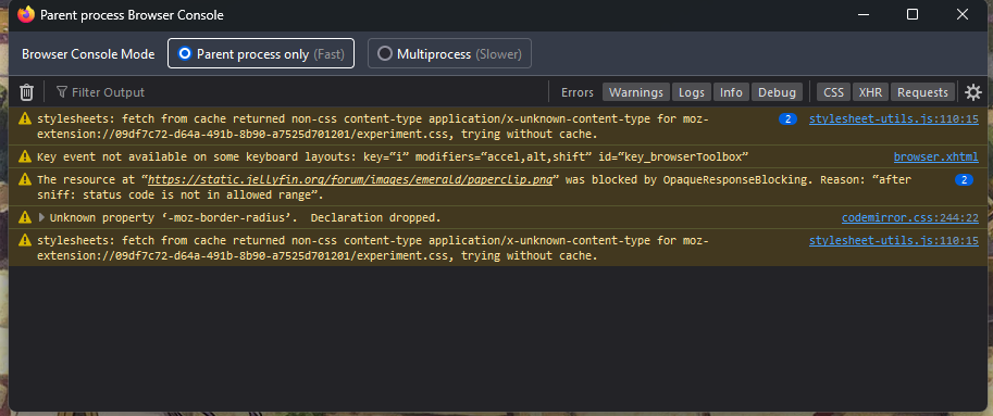

RE: PC Video Playing Issue - Roguediculous - 2024-05-28
(2024-05-27, 11:20 PM)TheDreadPirate Wrote: That log is still showing a clean ffmpeg run.
Which client are you using on your PC?  Looks like a browser.  Which one?
Can you open the developer console in the browser, replicate the problem, and then report any thing you see in the developer console.
Here is a screenshot not sure if thats what your asking for?
The version of Jellyfin you are running (e.g. 10.8.10)
9.3.3 - Ubuntu Proxmox Container, and this only happens in the web browser but I am unsure of the desktop application. However it does work on my android tvs application without fail.
I have tried Edge / FireFox
RE: PC Video Playing Issue - TheDreadPirate - 2024-05-28
Can you make a backup of your Jellyfin data and try upgrading to at least 10.8.13? I vaguely recall there being quite a few jellyfin-web bugs resembling this.
