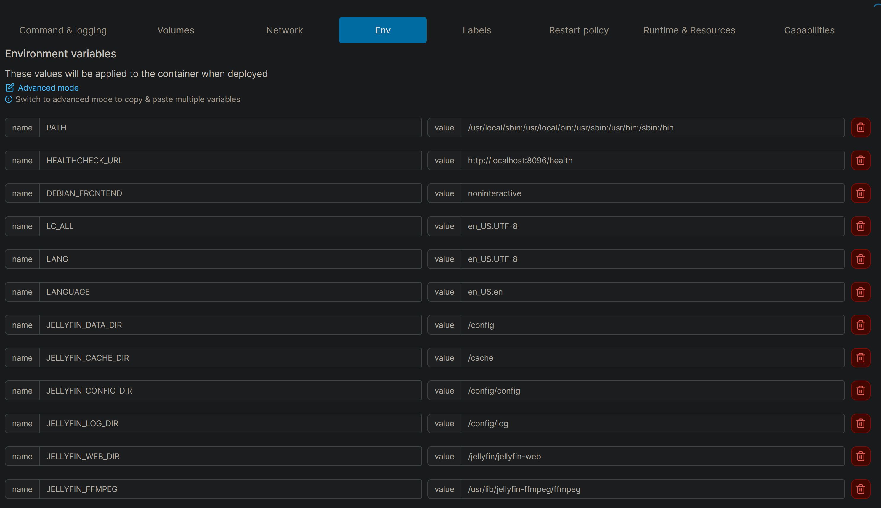

Playback issues after update - Despair - 2024-07-08 After the update to 10.9.7, or maybe the one before (I'm not sure), I cannot play a lot of files: after a bit of troubleshooting I think playback fails if transcoding is involved, because I found those lines in the logfile: root@jellyfin:/config/log# cat log_20240708.log | grep ffmpeg [2024-07-08 11:35:50.070 +00:00] [INF] [1] Main: Environment Variables: ["[JELLYFIN_FFMPEG, /usr/lib/jellyfin-ffmpeg/ffmpeg]", "[JELLYFIN_CONFIG_DIR, /config/config]", "[DOTNET_SYSTEM_GLOBALIZATION_INVARIANT, 1]", "[JELLYFIN_MEDIA_DIR, /media]", "[JELLYFIN_DATA_DIR, /config]", "[JELLYFIN_LOG_DIR, /config/log]", "[JELLYFIN_CACHE_DIR, /cache]", "[JELLYFIN_WEB_DIR, /jellyfin/jellyfin-web]"] [2024-07-08 11:35:50.076 +00:00] [INF] [1] Main: Arguments: ["/jellyfin/jellyfin.dll", "--datadir", "/config", "--cachedir", "/cache", "--ffmpeg", "/usr/local/bin/ffmpeg"] System.ComponentModel.Win32Exception (2): An error occurred trying to start process '/usr/local/bin/ffmpeg' with working directory '/'. No such file or directory [2024-07-08 11:39:48.326 +00:00] [WRN] [1] MediaBrowser.MediaEncoding.Encoder.MediaEncoder: FFmpeg: Failed version check: "/usr/local/bin/ffmpeg" I tried to search online for this issue, and I found people suggesting to set the ffmpeg path under Settings > Playback, but on my server the field is empty and greyed out. Server version: 10.9.7 - latest official docker image Client version: WebUI on Firefox, latest app on WebOS, same issue OS: Archlinux RE: Playback issues after update - TheDreadPirate - 2024-07-08 At some point were you trying to use a different ffmpeg than what is bundled with Jellyfin? The path it is looking at is not the default path. Should be /usr/lib/jellyfin-ffmpeg/ffmpeg. RE: Playback issues after update - Despair - 2024-07-08 Never tried to change ffmpeg, always used the default confguration. The strange thing is, in the first line, seems like it is aware of the right path: [JELLYFIN_FFMPEG, /usr/lib/jellyfin-ffmpeg/ffmpeg] but after that it tries to launch ffmpeg from /usr/local/bin/ffmpeg RE: Playback issues after update - TheDreadPirate - 2024-07-08 Can you share the contents of container path /config/config/encoding.xml? Whatever that translates to for your host path. RE: Playback issues after update - theguymadmax - 2024-07-08 Are you manually running Jellyfin from the terminal? Never mind, I see you're using docker. RE: Playback issues after update - Despair - 2024-07-08 (2024-07-08, 03:13 PM)theguymadmax Wrote: Are you manually running Jellyfin from the terminal? Never mind, I see you're using docker. No, I'm not. It starts with the container, I suppose this is the default way to do? (2024-07-08, 03:13 PM)TheDreadPirate Wrote: Can you share the contents of container path /config/config/encoding.xml? Whatever that translates to for your host path. Sure, here you go. RE: Playback issues after update - TheDreadPirate - 2024-07-08 What does your docker compose look like? Your encoding.xml file has the right path for ffmpeg. RE: Playback issues after update - Despair - 2024-07-08 (2024-07-08, 03:25 PM)TheDreadPirate Wrote: What does your docker compose look like? Your encoding.xml file has the right path for ffmpeg. I don't have a docker compose, I just run the container. I have a bunch of containers, so I use Portainer to manage them because it's a bit easier and faster. RE: Playback issues after update - TheDreadPirate - 2024-07-08 In the Portainer page for Jellyfin are there any environment variables that would change the ffmpeg path? RE: Playback issues after update - theguymadmax - 2024-07-08 In Portainer under Local click on your Containers then select your Jellyfin container. Then click the “Duplicate/Edit” Menu under Actions on the top menu. Under “Advanced container settings” select “Env”. Does your ffmpeg path match my screenshot? If not then go ahead and change it. |
