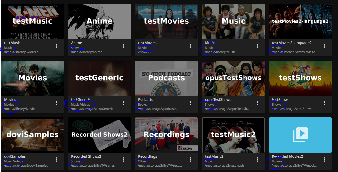

Library setup - alleycat - 2024-10-01 When we first setup a library, it asks what type of content it will contain movies, shows, music, etc... How can I go back and see how I first set it up as? Also can I change the type or do I have to start over with a new library creation? RE: Library setup - TheDreadPirate - 2024-10-01 You cannot change the type after initially setting it. The is in Dashboard > Library, right under the name of the library. RE: Library setup - alleycat - 2024-10-01 (2024-10-01, 01:09 PM)TheDreadPirate Wrote: You cannot change the type after initially setting it. The is in Dashboard > Library, right under the name of the library. OK, thanks. I guess I'm going to delete the library (copy files first), recreate and rescan. I was reading the docs and it mentioned don't mix the types even though it's in the pull down menu? RE: Library setup - TheDreadPirate - 2024-10-01 Mixed libraries are a legacy feature that is not maintained and is very buggy. And there have been discussions about removing the ability to add new mixed libraries in the future. |
