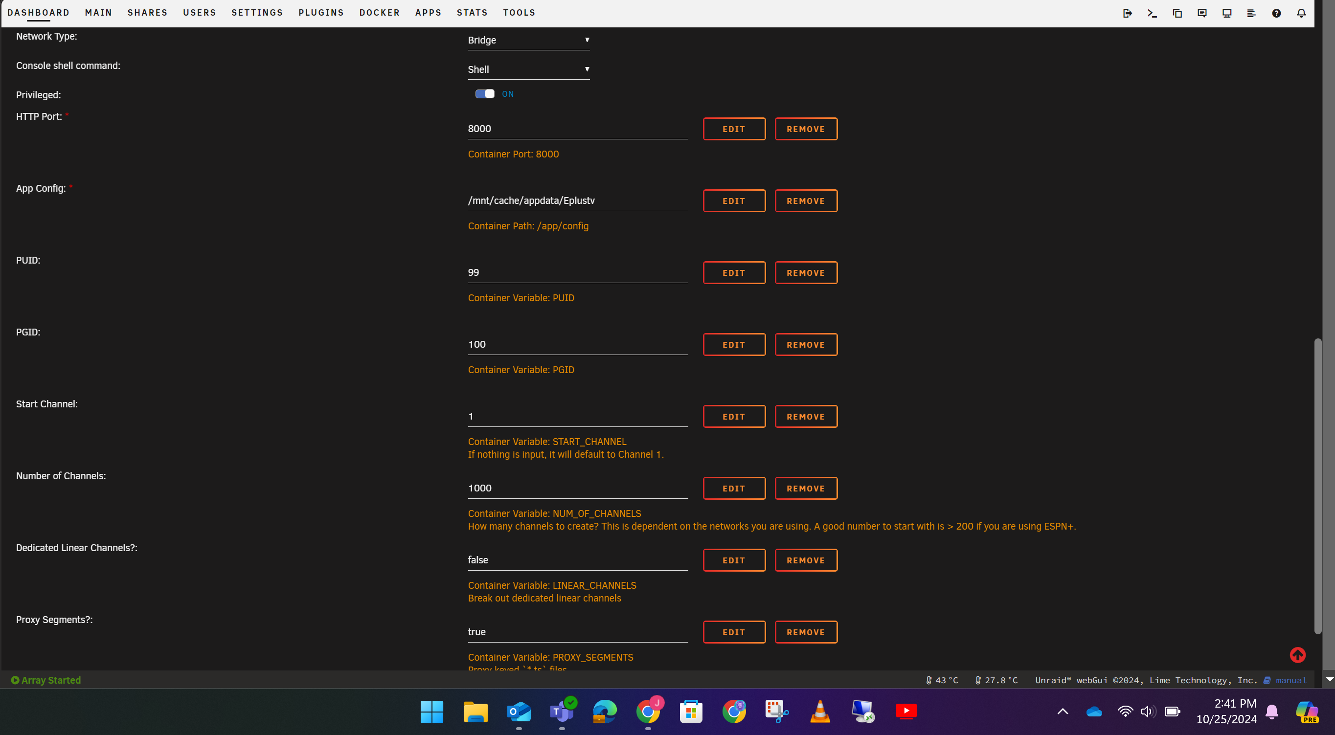

Also, how do you have EPlusTV configured? Is PROXY_SEGMENTS enabled?
RE: Jellyfin causing Unraid to Crash - jmvbrown - 2024-10-25
I've tried with and without PROXY_SEGMENTS enabled and it happens.
