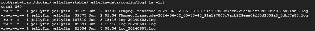

    2024-06-05, 01:42 PM
    In the Docker settings, you defined a location on the host file system to mount /config.  In that folder there should be a log directory.  Can you share the main jellyfin log and one of the FFMPEG logs?
    difuguilai
    Posts: 18
    Country:China
    2024-06-12, 12:44 AM (This post was last modified: 2024-06-12, 12:44 AM by difuguilai.)
    {"Protocol":0,"Id":"a854afa0cacb8feb2aee2df0c32dc3cf","Path":"/media/\u5916\u8BED\u7535\u5F71/2012 (2009)/2012 (2009) - 720p.rmvb","EncoderPath":null,"EncoderProtocol":null,"Type":0,"Container":"rm","Size":1665762261,"Name":"720p","IsRemote":false,"ETag":"255c0b49e03e7d11da1a23a25dfb87ce","RunTimeTicks":94695150000,"ReadAtNativeFramerate":false,"IgnoreDts":false,"IgnoreIndex":false,"GenPtsInput":false,"SupportsTranscoding":true,"SupportsDirectStream":true,"SupportsDirectPlay":true,"IsInfiniteStream":false,"RequiresOpening":false,"OpenToken":null,"RequiresClosing":false,"LiveStreamId":null,"BufferMs":null,"RequiresLooping":false,"SupportsProbing":true,"VideoType":0,"IsoType":null,"Video3DFormat":null,"MediaStreams":[{"Codec":"rv40","CodecTag":"RV40","Language":null,"ColorRange":null,"ColorSpace":null,"ColorTransfer":null,"ColorPrimaries":null,"DvVersionMajor":null,"DvVersionMinor":null,"DvProfile":null,"DvLevel":null,"RpuPresentFlag":null,"ElPresentFlag":null,"BlPresentFlag":null,"DvBlSignalCompatibilityId":null,"Comment":null,"TimeBase":"1/1000","CodecTimeBase":null,"Title":null,"VideoRange":1,"VideoRangeType":1,"VideoDoViTitle":null,"AudioSpatialFormat":0,"LocalizedUndefined":null,"LocalizedDefault":null,"LocalizedForced":null,"LocalizedExternal":null,"LocalizedHearingImpaired":null,"DisplayTitle":"720p RV40 SDR","NalLengthSize":null,"IsInterlaced":false,"IsAVC":false,"ChannelLayout":null,"BitRate":1332213,"BitDepth":8,"RefFrames":1,"PacketLength":null,"Channels":null,"SampleRate":null,"IsDefault":false,"IsForced":false,"IsHearingImpaired":false,"Height":720,"Width":1280,"AverageFrameRate":23.976044,"RealFrameRate":23.976044,"Profile":null,"Type":1,"AspectRatio":"16:9","Index":0,"Score":null,"IsExternal":false,"DeliveryMethod":null,"DeliveryUrl":null,"IsExternalUrl":null,"IsTextSubtitleStream":false,"SupportsExternalStream":false,"Path":null,"PixelFormat":"yuv420p","Level":-99,"IsAnamorphic":false},{"Codec":"aac","CodecTag":"racp","Language":null,"ColorRange":null,"ColorSpace":null,"ColorTransfer":null,"ColorPrimaries":null,"DvVersionMajor":null,"DvVersionMinor":null,"DvProfile":null,"DvLevel":null,"RpuPresentFlag":null,"ElPresentFlag":null,"BlPresentFlag":null,"DvBlSignalCompatibilityId":null,"Comment":null,"TimeBase":"1/1000","CodecTimeBase":null,"Title":null,"VideoRange":0,"VideoRangeType":0,"VideoDoViTitle":null,"AudioSpatialFormat":0,"LocalizedUndefined":null,"LocalizedDefault":null,"LocalizedForced":null,"LocalizedExternal":null,"LocalizedHearingImpaired":null,"DisplayTitle":"AAC - Stereo","NalLengthSize":null,"IsInterlaced":false,"IsAVC":false,"ChannelLayout":"stereo","BitRate":64000,"BitDepth":null,"RefFrames":null,"PacketLength":null,"Channels":2,"SampleRate":44100,"IsDefault":false,"IsForced":false,"IsHearingImpaired":false,"Height":null,"Width":null,"AverageFrameRate":null,"RealFrameRate":null,"Profile":"HE-AAC","Type":0,"AspectRatio":null,"Index":1,"Score":null,"IsExternal":false,"DeliveryMethod":null,"DeliveryUrl":null,"IsExternalUrl":null,"IsTextSubtitleStream":false,"SupportsExternalStream":false,"Path":null,"PixelFormat":null,"Level":0,"IsAnamorphic":null}],"MediaAttachments":[],"Formats":[],"Bitrate":1407263,"Timestamp":null,"RequiredHttpHeaders":{},"TranscodingUrl":null,"TranscodingSubProtocol":0,"TranscodingContainer":null,"AnalyzeDurationMs":null,"DefaultAudioStreamIndex":null,"DefaultSubtitleStreamIndex":null}

    MediaBrowser.Common.FfmpegException: FFmpeg exited with code 1
    at MediaBrowser.MediaEncoding.Transcoding.TranscodeManager.StartFfMpeg(StreamState state, String outputPath, String commandLineArguments, Guid userId, TranscodingJobType transcodingJobType, CancellationTokenSource cancellationTokenSource, String workingDirectory)
    at Jellyfin.Api.Controllers.DynamicHlsController.GetHlsVideoSegment(Guid itemId, String playlistId, Int32 segmentId, String container, Int64 runtimeTicks, Int64 actualSegmentLengthTicks, Nullable1 static, String params, String tag, String deviceProfileId, String playSessionId, String segmentContainer, Nullable1 segmentLength, Nullable1 minSegments, String mediaSourceId, String deviceId, String audioCodec, Nullable1 enableAutoStreamCopy, Nullable1 allowVideoStreamCopy, Nullable1 allowAudioStreamCopy, Nullable1 breakOnNonKeyFrames, Nullable1 audioSampleRate, Nullable1 maxAudioBitDepth, Nullable1 audioBitRate, Nullable1 audioChannels, Nullable1 maxAudioChannels, String profile, String level, Nullable1 framerate, Nullable1 maxFramerate, Nullable1 copyTimestamps, Nullable1 startTimeTicks, Nullable1 width, Nullable1 height, Nullable1 maxWidth, Nullable1 maxHeight, Nullable1 videoBitRate, Nullable1 subtitleStreamIndex, Nullable1 subtitleMethod, Nullable1 maxRefFrames, Nullable1 maxVideoBitDepth, Nullable1 requireAvc, Nullable1 deInterlace, Nullable1 requireNonAnamorphic, Nullable1 transcodingMaxAudioChannels, Nullable1 cpuCoreLimit, String liveStreamId, Nullable1 enableMpegtsM2TsMode, String videoCodec, String subtitleCodec, String transcodeReasons, Nullable1 audioStreamIndex, Nullable1 videoStreamIndex, Nullable1 context, Dictionary2 streamOptions)
    at lambda_method1246(Closure, Object)
    at Microsoft.AspNetCore.Mvc.Infrastructure.ControllerActionInvoker.<InvokeActionMethodAsync>g__Awaited|12_0(ControllerActionInvoker invoker, ValueTask
    1 actionResultValueTask)
    [2024-06-12 00:42:50.411 +00:00] [INF] [143] Jellyfin.Api.Helpers.MediaInfoHelper: User policy for "liujun". EnablePlaybackRemuxing: True EnableVideoPlaybackTranscoding: True EnableAudioPlaybackTranscoding: True
    [2024-06-12 00:42:50.431 +00:00] [INF] [143] MediaBrowser.MediaEncoding.Transcoding.TranscodeManager: Deleting partial stream file(s) "/config/transcodes/022f8ba478f7006795552c6f1951ea91.m3u8"
    [2024-06-12 00:42:50.520 +00:00] [INF] [17] Jellyfin.Api.Controllers.DynamicHlsController: Current HLS implementation doesn't support non-keyframe breaks but one is requested, ignoring that request
    [2024-06-12 00:42:50.521 +00:00] [INF] [17] MediaBrowser.MediaEncoding.Transcoding.TranscodeManager: "/usr/lib/jellyfin-ffmpeg/ffmpeg" "-analyzeduration 200M -probesize 1G -init_hw_device vaapi=vaConfused-facedev/dri/renderD128,driver=iHD -hwaccel vaapi -hwaccel_output_format vaapi -noautorotate -i file:\"/links/外语电影/2012 (2009)/2012 (2009) - 1080p.mkv\" -noautoscale -map_metadata -1 -map_chapters -1 -threads 0 -map 0:0 -map 0:1 -map -0:s -codec:v:0 av1_vaapi -rc_mode VBR -b:v 5635559 -maxrate 5635559 -bufsize 11271118 -force_key_frames:0 \"expr:gte(t,n_forced*3)\" -vf \"setparams=color_primaries=bt709:color_trc=bt709:colorspace=bt709,scale_vaapi=format=nv12:extra_hw_frames=24\" -codec:a:0 ac3 -ac 6 -ab 640000 -ar 48000 -copyts -avoid_negative_ts disabled -max_muxing_queue_size 2048 -f hls -max_delay 5000000 -hls_time 3 -hls_segment_type fmp4 -hls_fmp4_init_filename \"32531d1ddf187deade6bc5029e782dc1-1.mp4\" -start_number 0 -hls_segment_filename \"/config/transcodes/32531d1ddf187deade6bc5029e782dc1%d.mp4\" -hls_playlist_type vod -hls_list_size 0 -y \"/config/transcodes/32531d1ddf187deade6bc5029e782dc1.m3u8\""
    [2024-06-12 00:42:50.551 +00:00] [ERR] [139] MediaBrowser.MediaEncoding.Transcoding.TranscodeManager: FFmpeg exited with code 1
    [2024-06-12 00:42:50.645 +00:00] [ERR] [139] Jellyfin.Api.Middleware.ExceptionMiddleware: Error processing request. URL "GET" "/videos/0de5f317-135b-0371-a836-ddf579c19ca6/hls1/main/-1.mp4".
    [2024-06-12 00:42:50.732 +00:00] [INF] [139] MediaBrowser.MediaEncoding.Transcoding.TranscodeManager: Deleting partial stream file(s) "/config/transcodes/32531d1ddf187deade6bc5029e782dc1.m3u8"
    [2024-06-12 00:42:52.246 +00:00] [INF] [17] Emby.Server.Implementations.Session.SessionManager: Playback stopped reported by app "Jellyfin Web" "10.9.4" playing "2012 (2009)". Stopped at "0" ms
    [2024-06-12 00:42:56.849 +00:00] [INF] [17] Jellyfin.Api.Helpers.MediaInfoHelper: User policy for "liujun". EnablePlaybackRemuxing: True EnableVideoPlaybackTranscoding: True EnableAudioPlaybackTranscoding: True
    [2024-06-12 00:42:57.268 +00:00] [INF] [142] Jellyfin.Api.Controllers.DynamicHlsController: Current HLS implementation doesn't support non-keyframe breaks but one is requested, ignoring that request
    [2024-06-12 00:42:57.268 +00:00] [INF] [142] MediaBrowser.MediaEncoding.Transcoding.TranscodeManager: "/usr/lib/jellyfin-ffmpeg/ffmpeg" "-analyzeduration 200M -probesize 1G -init_hw_device vaapi=vaConfused-facedev/dri/renderD128,driver=iHD -noautorotate -i file:\"/media/外语电影/2012 (2009)/2012 (2009) - 720p.rmvb\" -map_metadata -1 -map_chapters -1 -threads 0 -map 0:0 -map 0:1 -map -0:s -codec:v:0 av1_vaapi -rc_mode VBR -b:v 3330532 -maxrate 3330532 -bufsize 6661064 -force_key_frames:0 \"expr:gte(t,n_forced*3)\" -vf \"setparams=color_primaries=bt709:color_trc=bt709:colorspace=bt709,scale=trunc(min(max(iw\,ih*a)\,min(1280\,720*a))/2)*2:trunc(min(max(iw/a\,ih)\,min(1280/a\,720))/2)*2,format=nv12,hwupload_vaapi\" -codec:a:0 copy -copyts -avoid_negative_ts disabled -max_muxing_queue_size 2048 -f hls -max_delay 5000000 -hls_time 3 -hls_segment_type fmp4 -hls_fmp4_init_filename \"1f8177d35bb6723ac9ffd23c3d73919b-1.mp4\" -start_number 0 -hls_segment_filename \"/config/transcodes/1f8177d35bb6723ac9ffd23c3d73919b%d.mp4\" -hls_playlist_type vod -hls_list_size 0 -y \"/config/transcodes/1f8177d35bb6723ac9ffd23c3d73919b.m3u8\""
    [2024-06-12 00:42:57.419 +00:00] [ERR] [142] MediaBrowser.MediaEncoding.Transcoding.TranscodeManager: FFmpeg exited with code 1
    [2024-06-12 00:42:57.487 +00:00] [ERR] [142] Jellyfin.Api.Middleware.ExceptionMiddleware: Error processing request. URL "GET" "/videos/0de5f317-135b-0371-a836-ddf579c19ca6/hls1/main/-1.mp4".
    [2024-06-12 00:42:57.611 +00:00] [INF] [139] Jellyfin.Api.Helpers.MediaInfoHelper: User policy for "liujun". EnablePlaybackRemuxing: True EnableVideoPlaybackTranscoding: True EnableAudioPlaybackTranscoding: True
    [2024-06-12 00:42:57.624 +00:00] [INF] [139] MediaBrowser.MediaEncoding.Transcoding.TranscodeManager: Deleting partial stream file(s) "/config/transcodes/1f8177d35bb6723ac9ffd23c3d73919b.m3u8"
    [2024-06-12 00:42:57.750 +00:00] [INF] [49] Jellyfin.Api.Controllers.DynamicHlsController: Current HLS implementation doesn't support non-keyframe breaks but one is requested, ignoring that request
    [2024-06-12 00:42:57.751 +00:00] [INF] [49] MediaBrowser.MediaEncoding.Transcoding.TranscodeManager: "/usr/lib/jellyfin-ffmpeg/ffmpeg" "-analyzeduration 200M -probesize 1G -init_hw_device vaapi=vaConfused-facedev/dri/renderD128,driver=iHD -noautorotate -i file:\"/media/外语电影/2012 (2009)/2012 (2009) - 720p.rmvb\" -map_metadata -1 -map_chapters -1 -threads 0 -map 0:0 -map 0:1 -map -0:s -codec:v:0 av1_vaapi -rc_mode VBR -b:v 3330532 -maxrate 3330532 -bufsize 6661064 -force_key_frames:0 \"expr:gte(t,n_forced*3)\" -vf \"setparams=color_primaries=bt709:color_trc=bt709:colorspace=bt709,scale=trunc(min(max(iw\,ih*a)\,min(1280\,720*a))/2)*2:trunc(min(max(iw/a\,ih)\,min(1280/a\,720))/2)*2,format=nv12,hwupload_vaapi\" -codec:a:0 copy -copyts -avoid_negative_ts disabled -max_muxing_queue_size 2048 -f hls -max_delay 5000000 -hls_time 3 -hls_segment_type fmp4 -hls_fmp4_init_filename \"e9a08d7c6dcb50d0965da4c6e0fb66f3-1.mp4\" -start_number 0 -hls_segment_filename \"/config/transcodes/e9a08d7c6dcb50d0965da4c6e0fb66f3%d.mp4\" -hls_playlist_type vod -hls_list_size 0 -y \"/config/transcodes/e9a08d7c6dcb50d0965da4c6e0fb66f3.m3u8\""
    [2024-06-12 00:42:57.862 +00:00] [ERR] [139] MediaBrowser.MediaEncoding.Transcoding.TranscodeManager: FFmpeg exited with code 1
    [2024-06-12 00:42:57.895 +00:00] [ERR] [139] Jellyfin.Api.Middleware.ExceptionMiddleware: Error processing request. URL "GET" "/videos/0de5f317-135b-0371-a836-ddf579c19ca6/hls1/main/-1.mp4".
    [2024-06-12 00:42:57.912 +00:00] [INF] [49] Jellyfin.Api.Helpers.MediaInfoHelper: User policy for "liujun". EnablePlaybackRemuxing: True EnableVideoPlaybackTranscoding: True EnableAudioPlaybackTranscoding: True
    [2024-06-12 00:42:57.920 +00:00] [INF] [134] MediaBrowser.MediaEncoding.Transcoding.TranscodeManager: Deleting partial stream file(s) "/config/transcodes/e9a08d7c6dcb50d0965da4c6e0fb66f3.m3u8"
    [2024-06-12 00:42:58.011 +00:00] [INF] [49] Jellyfin.Api.Controllers.DynamicHlsController: Current HLS implementation doesn't support non-keyframe breaks but one is requested, ignoring that request
    [2024-06-12 00:42:58.012 +00:00] [INF] [49] MediaBrowser.MediaEncoding.Transcoding.TranscodeManager: "/usr/lib/jellyfin-ffmpeg/ffmpeg" "-analyzeduration 200M -probesize 1G -init_hw_device vaapi=vaConfused-facedev/dri/renderD128,driver=iHD -noautorotate -i file:\"/media/外语电影/2012 (2009)/2012 (2009) - 720p.rmvb\" -map_metadata -1 -map_chapters -1 -threads 0 -map 0:0 -map 0:1 -map -0:s -codec:v:0 av1_vaapi -rc_mode VBR -b:v 3330532 -maxrate 3330532 -bufsize 6661064 -force_key_frames:0 \"expr:gte(t,n_forced*3)\" -vf \"setparams=color_primaries=bt709:color_trc=bt709:colorspace=bt709,scale=trunc(min(max(iw\,ih*a)\,min(1280\,720*a))/2)*2:trunc(min(max(iw/a\,ih)\,min(1280/a\,720))/2)*2,format=nv12,hwupload_vaapi\" -codec:a:0 libfdk_aac -ac 2 -ab 64000 -ar 44100 -copyts -avoid_negative_ts disabled -max_muxing_queue_size 2048 -f hls -max_delay 5000000 -hls_time 3 -hls_segment_type fmp4 -hls_fmp4_init_filename \"c4ebfa6f12f9100ca47fca1021fcc32e-1.mp4\" -start_number 0 -hls_segment_filename \"/config/transcodes/c4ebfa6f12f9100ca47fca1021fcc32e%d.mp4\" -hls_playlist_type vod -hls_list_size 0 -y \"/config/transcodes/c4ebfa6f12f9100ca47fca1021fcc32e.m3u8\""
    [2024-06-12 00:42:58.104 +00:00] [ERR] [134] MediaBrowser.MediaEncoding.Transcoding.TranscodeManager: FFmpeg exited with code 1
    [2024-06-12 00:42:58.130 +00:00] [ERR] [142] Jellyfin.Api.Middleware.ExceptionMiddleware: Error processing request. URL "GET" "/videos/0de5f317-135b-0371-a836-ddf579c19ca6/hls1/main/-1.mp4".
    [2024-06-12 00:42:58.250 +00:00] [INF] [49] MediaBrowser.MediaEncoding.Transcoding.TranscodeManager: Deleting partial stream file(s) "/config/transcodes/c4ebfa6f12f9100ca47fca1021fcc32e.m3u8"
    [2024-06-12 00:42:59.751 +00:00] [INF] [142] Emby.Server.Implementations.Session.SessionManager: Playback stopped reported by app "Jellyfin Web" "10.9.4" playing "2012 (2009)". Stopped at "0" ms
    [2024-06-12 00:44:39.309 +00:00] [INF] [136] Emby.Server.Implementations.Session.SessionWebSocketListener: Sending ForceKeepAlive message to 1 inactive WebSockets.
    播放影片 2012 时,提示发现致命错误,播放失败,求大佬指点迷津,谢谢
