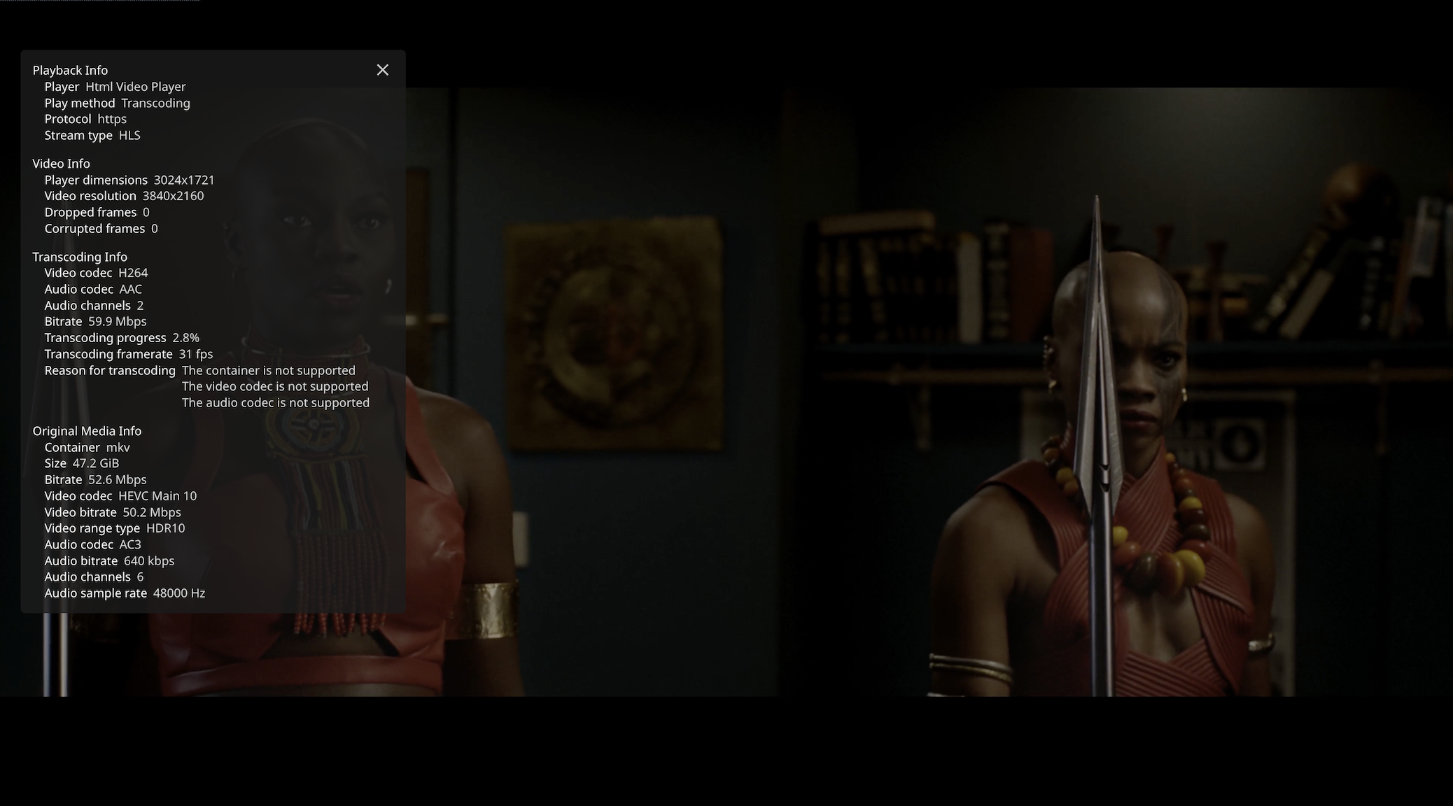

    Also....interesting enough... when I am using my non 4K devices to stream my 4k movies with hardware acceleration (using igpu on server) turned on, none of my movies play. However, if I turn this off. The playback even on my 4k movies is as smooth as butter. I am genuinely confused about this as I was under the assumption I had to have HW acceleration turned on to stream 4k movies on non-4k devices
    I will attach screenshot of example.
    I am currently streaming this video that is 4k from my home server to my macbook remotely via jellyfin web address
    Right now, I currently have HW acceleration turned off in my dashboard and it is running with zero issues. The minute I turn HW acceleration on in my dashboard, my movies do not play.
