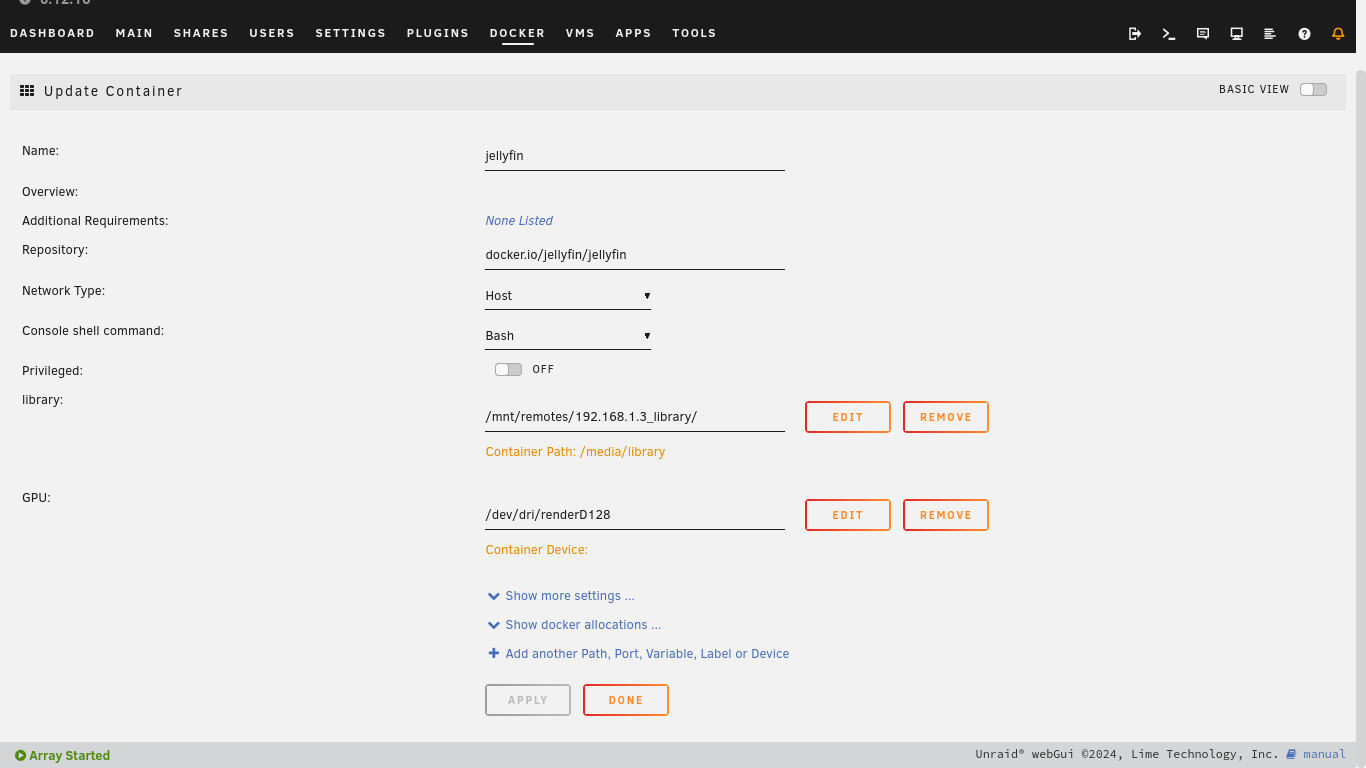

    I have a test UNRAID setup.  This is all I had to do to get the GPU into the container.
    Can you show me your container setup for the Jellyfin container?
