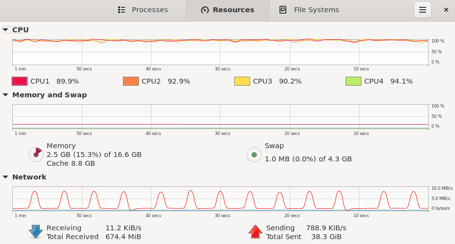

    So I have reworked my network a bit to allow uPnP. The main devices I will be streaming from will be Xbox. My xbox consoles tell me that uPnP is working yet when I play files from the JellyFin app, my server still seems to be the device doing all the work, as the CPU goes through the roof and playback becomes laggy.

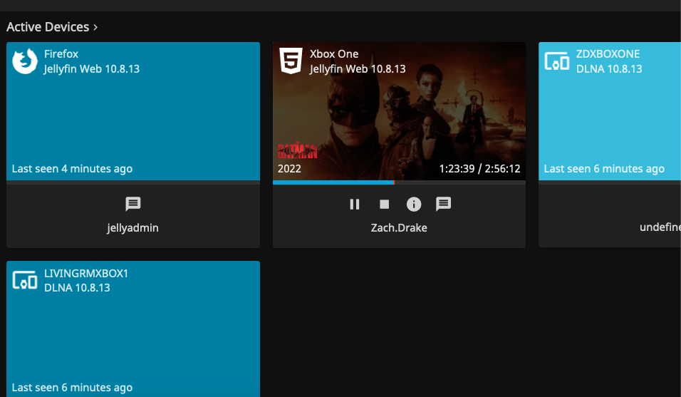

    After lowering the Client Discover Interval to 30 seconds (As recommended for some clients), I do now see an xbox showing as a DLNA device in the active devices tab, but not sure its working correctly since the CPU is still running high on the server. I feel like I'm close but missing something still.

    uPnP is not needed for LAN playback. It sounds like the Jellyfin DLNA server is using the generic profile and is transcoding. You will need to create or find a DLNA profile for your Xbox and import that into Jellyfin. Assuming your media's codecs match the Xbox's capabilities it will direct play.

    Figured this out last night, it is in fact working now after the network changes, but the file I was testing with initially was 4k HEVC, and it seems my Xbox One cannot direct play at that quality, so the server transcodes it into 1080p, causing the CPU spike. My Xbox series S was showing the same behavior. When I streamed another movie file that was natively 1080p, it direct plays without issue on both consoles.

    I'm a little confused as to your setup, because if you have the jellyfin app installed on the device, then DLNA isn't being used.  It's trying to stream over http like every other client does.  DLNA is for devices that don't have a client app.

    DLNA is just a generic protocol for streaming media. Jellyfin goes the extra step of making some attempt to ensure that devices can play the media well. If it doesn't have a profile for your device, it uses a conservative generic profile and converts to very compatible codecs. You can create custom DLNA profiles that specify what your device can handle and then Jellyfin will send the files, unmodified, when the file fits within that custom DLNA profile.
