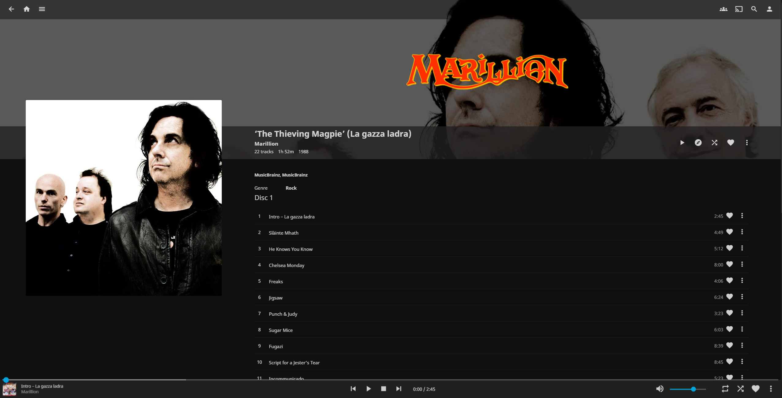

    Also when playing these Songs from Jellyfin they also show up in the bottom left corner
    But when looking at the album (either in the list of albums or when expanding it to see all songs) this image is nowhere to be seen      .

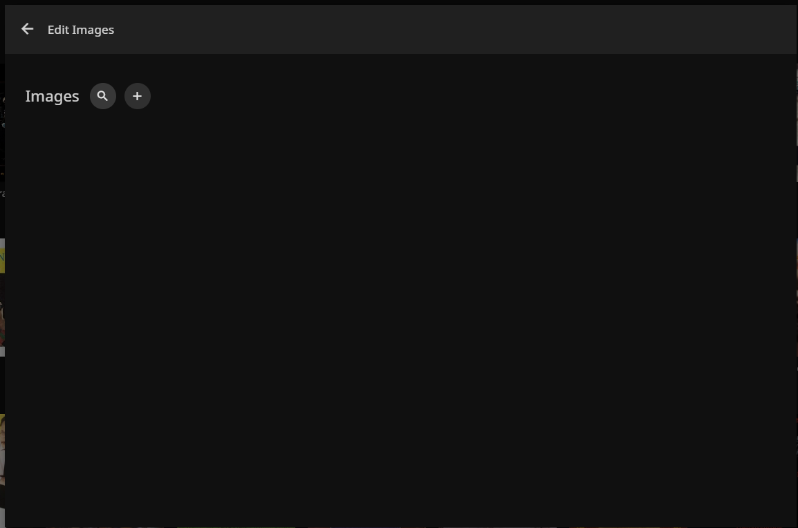

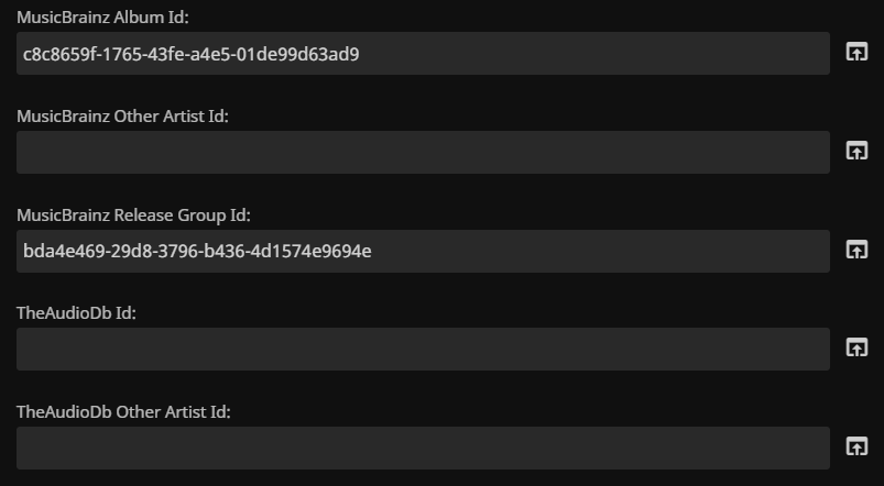

    The Edit Images dialog window is empty.      Oddly enough the album has the correct Musicbrainz ID associated with it and there is an image on the website available. For some reason it just doesn't seem to wanna use either the embeded one, nor download one from Musicbrainz.
