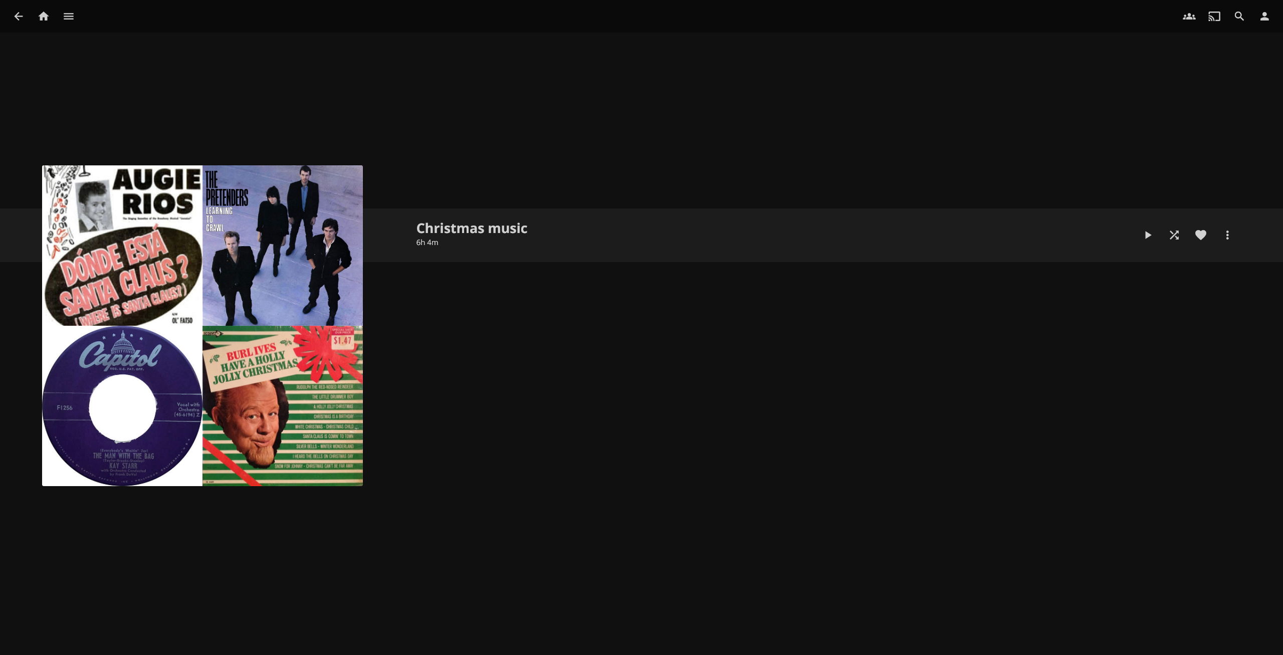

    I only have one music playlist in Jellyfin. I went to play it today, for the first time in just under a year (it is a Christmas music playlist), but when I tried to play it, I realised none of the songs appear in the playlist - but the duration of the playlist still shows in Jellyfin, and the tracks can be played individually from Jellyfin, so I know they haven't been deleted.
    I have attached what I see when I view the playlist in the web interface. You will see it still lists the duration of the playlist (6h 4m), so the playlist *should* still be intact somewhere.

    EDIT: I just updated to 10.10.1. It made no difference except the duration (6h 4m in the previous screenshot) has now disappeared. Attached is how it looks now.

    There is nothing in the log.
    What probably happened is that at some point in the last year the files for your Christmas Music were unavailable during Jellyfin startup. There is a job, that only triggers on startup, that will examine your playlists and collections and remove items that are no longer present. If your D drive was unavailable it would have cleared out that entire playlist.
