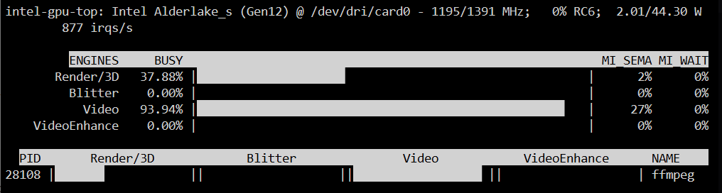

    Pretty new to everything Jellyfin
    CPU is a 100% while transcoding, but it appears the iGPU isn’t working very hard:
    Or is it just a matter of working/not working and this is just expected performance?
    Jellyfin is deployed as a docker from the linuxserver repository on my unraid system.
    Intel Quicksync (QSV) has been enabled.
    Intel GPU TOP plugin is installed and the --device=/dev/dri:/dev/dri flag has been added
    System
    CPU: 12th Gen Intel® Core™ i3-12100 @ 3267 MHz
    Memory: 32 GiB DDR4

    2024-03-13, 08:46 PM
    It is using the iGPU.
    Stream #0:0 -> #0:0 (hevc (native) -> h264 (h264_qsv))
    Your video is a bit weird. It has 2 video streams? One with and without Dolby Vision?
    Did you apply the Intel OpenCL mod for the LSIO Jellyfin container? Can you share the full docker config for Jellyfin?

    2024-03-13, 09:56 PM (This post was last modified: 2024-03-13, 09:56 PM by TheDreadPirate. Edited 1 time in total.)
    You have to add an environment variable to the Docker config for Jellyfin.
    https://github.com/linuxserver/docker-mo...encl-intel
    DOCKER_MODS=linuxserver/mods:jellyfin-opencl-intel
    Since your video is HDR, you need the OpenCL mod.

    Thanks for the help. I've added the mod, but still CPU is running at 98~100%.
    2024-03-13, 10:29 PM
    For a sanity check, can you try another video? Preferably one that isn't HDR? The video we've been trying is a bit weird. Has two video streams.

    The first 4K HEVC 10 stream and a separate HEVC 10 + DOVI 7.6 stream that is 1080P instead of 4K? Its a bit unusual. Normally you have the HEVC and DV side channel in the same stream.

    Sorry - Took me a while to test out another video
    This one is better but still chewing up 85% ~ 90% CPU
    Here are the logs: https://sourceb.in/ZkVVVQDvJz
    iGPU looks a little better though?
    2024-03-15, 07:48 PM
    For testing, can you spin up a jellyfin/jellyfin docker image? I've found that the LSIO docker image behaves differently than the official image in a lot of weird ways. This may be another.
    Replace the group_add value with the GID of the render group on your PC. Add your media paths, etc.
