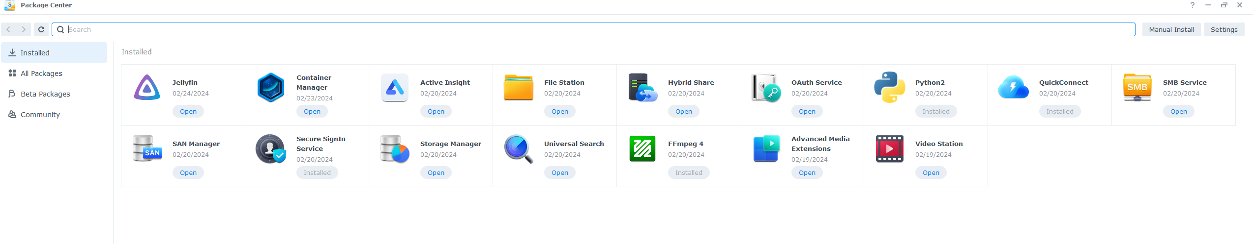

    Hi so I don't know what the issue is with my jellyfin server since I cannot connect to it from outside my network all of my settings like my reverse proxy,dns and where I have downlaoded jellyfin from are down below.
    My setup uses my nas with jellyfin installed through the packages part of the synology nas.
    On my synology nas you can use their own reverse proxy which I have done  with the settings down below . I have put my host name as my nas internal/local ip.
    I use duckdns as you can see for my dns. in the current ip I have put my external/public ip address.
    So through alot of research I have come down to it could be possibly one of the problems below if all my settings are correct hence why I posted them to make sure.
    My ISP Eero uses Cgnat for my IPV4
    My ISP is blocking ports 80 and 443
    If it is one of these problems is there anyway I can fix this or make use of a workaround that is free?
    thanks for any help and advice as allways it is much appreciated!
    Edit I have talked to my ISP and they have said that they do use Cgnat for IPV4. so now my question is how do I deal with this?
