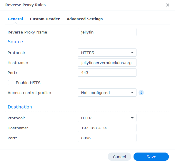

    On my synology nas you can use their own reverse proxy which I have done  with the settings down below . I have put my host name as my nas internal/local ip.

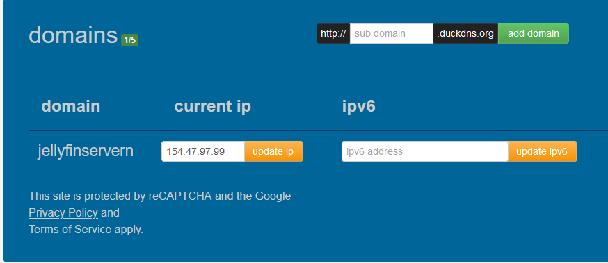

    I use duckdns as you can see for my dns. in the current ip I have put my external/public ip address.

    The Hostname field in your config is missing a dot between jellyfinserver and duckdns. If fixing that doesn't resolve the problem then we can continue troubleshooting.

    (2024-02-24, 04:10 PM)TheDreadPirate Wrote: The Hostname field in your config is missing a dot between jellyfinserver and duckdns.  If fixing that doesn't resolve the problem then we can continue troubleshooting.
    No that did not fix it and maybe I made a mistake somewhere since when I type in jellyfinservern.duckdns.org:8096 into my web browser on my pc I cant connect ethier.
    I also just had a chat with my ISP and they said that they do use Cgnat for IPV4. From what I have seen from other posts I won't now be able to host this jellyfin server for free. Aleast for anyone that wants to use it from outsode my network from my understanding.
