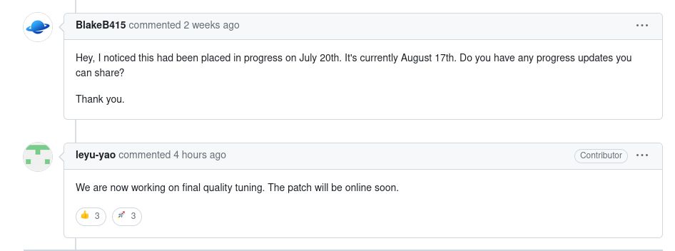

    AV1 ICQ mode is not yet supported on Linux. Intel is WIP. Don't use this.
    https://github.com/intel/media-driver/issues/1597
    -global_quality:v 18

    Oh boy, happened to check at the right time (AV1 ICQ patch quarterly patch)...
