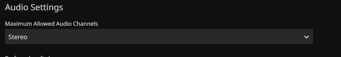

    Ah yes that's the issue I'm having then. I've set Maximum Allowed Audio Channels in both the normal web ui as well as JMP and this setting does not seem to be respected.
    [Image: image.png]

    2024-07-16, 08:43 PM
    Audio transcodes should honor that setting. I'm not sure if direct plays will honor that setting or if Jellyfin just downmixes locally or something.
