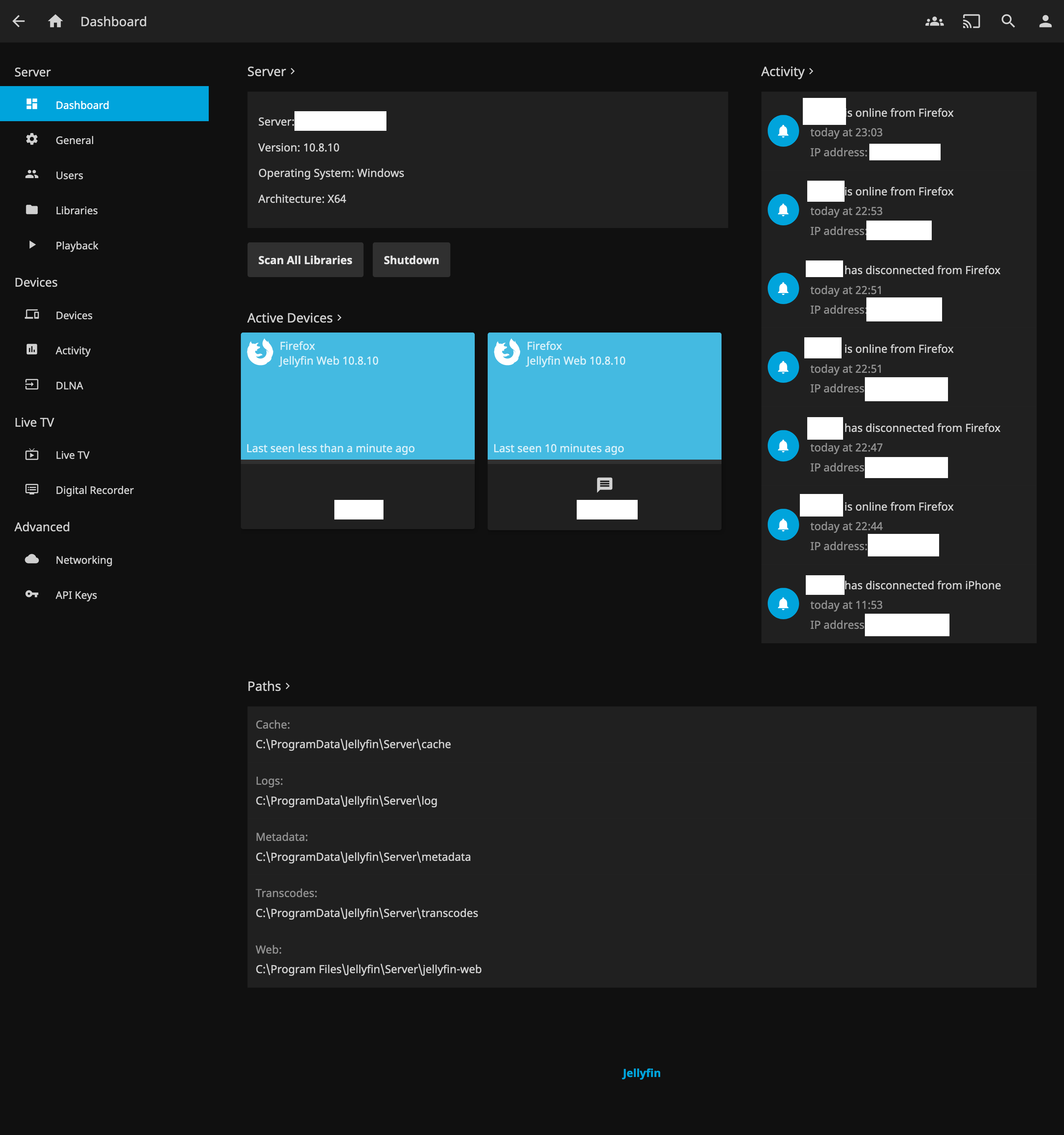

    Thank you for the response. I can't see those anywhere on the dashboard. What I can see is attached.
    2023-07-05, 10:19 PM
    I would just backup the entire C:\ProgramData\Jellyfin\Server directory. The database, by default, is at C:\ProgramData\Jellyfin\Server\data\jellyfin.db. That has all your metadata and watch progress, etc.
