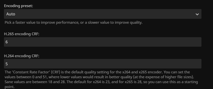

    I tried to change the encoding CRF to absurd values just for testing purposes, I see 0 differences, not in the slightest, I don't know if these values or used at all (or if I misconfigured something)

    IIRC, the 1.5X change in bit rate is hard coded when going from HEVC to H264. And changing the CRF only affects the quality when using CPU transcoding. If you are using NVENC that setting won't do anything.

    Quote:CRF only affects the quality when using CPU transcoding. If you are using NVENC that setting won't do anything.
    Oh I see, this explains why
