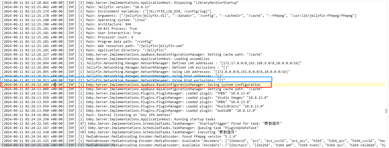

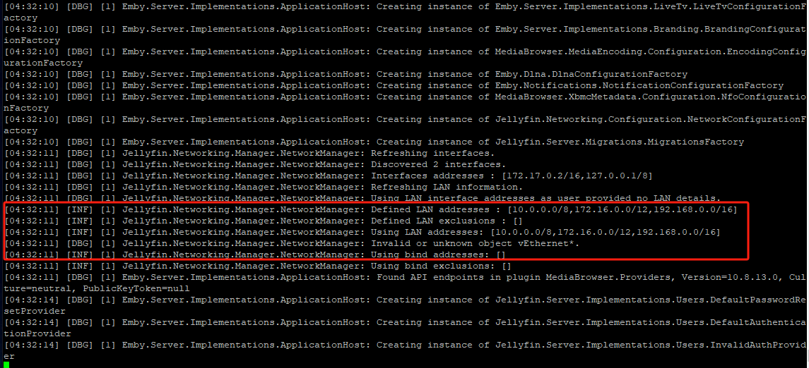

    [Image: jf-start-debug.png]
    The first issue is that the Jellyfin container takes a considerable amount of time, around 10-20 minutes, to start up and allow access to the web page. In contrast, the Emby container with the same media library only takes about a minute. I checked the Jellyfin logs and noticed that it always seems to pause at a specific point during startup for a long time before it continues to log output. I've captured a screenshot at this stage to share with you all, hoping someone can help me understand what's happening during this time. What could be causing this delay, and is there an effective way to speed up the process so that Jellyfin can reach the home page as quickly as Emby does?

    Jellyfin only takes about 5 seconds to boot on my system. Both my bare metal "production" instance and all 4 of my docker testing instances. Are your containers running off HDDs or SSDs?
    I'd need to see the full log. The section you are showing is only 4 seconds of the boot process. Share via sourcebin or pastebin.
    The "vEthernet" message is a default behavior of Jellyfin to ignore virtual interfaces with a particular name.

    Ignore the lan bit and the log entries after that and look in your log and see when it starts processing again after a long pause and start troubleshooting the last and next process after the log pause. It could be a plugin. I had like a 20-minute pause and disabled whatever plugin it was and things bounced back normally.
    That's all I got to offer as far as troubleshooting this.

    (2024-04-23, 04:40 AM)21tc_sea Wrote: Hello everyone!
    I've been running containers for both Jellyfin and Emby using Docker and have mounted the same media library to each. I am working with Jellyfin version 10.8.13 and Emby version 4.8.0.56. After starting the containers, I encountered a couple of issues with Jellyfin that I'm not sure how to resolve and would greatly appreciate any help or guidance from the community.

    Hello! My Jellyfin is installed on the Synology system using a Docker container. Every time it starts, it gets stuck at the same position and takes a long time to proceed to the next step, often more than ten minutes. You can take a look at the picture I put in the attachment, pay attention to the timestamps of the two log messages. From the logs, you can see that I waited at least 12 minutes for this startup. I’ve tried various methods but have been unable to solve this problem. I’m guessing if it’s because the database file is too large. In the data subdirectory of the config directory, the library.db database file is 3.5GB. My entire system only has 8GB of memory. I used the docker stats command to observe the Jellyfin container and found that it occupies around 4GB of memory as soon as it starts. It doesn’t return memory to the system when necessary, as everyone says. It only releases when the Jellyfin container is closed. However, with the same size of the database file, the Emby container can enter the web interface in less than a minute after startup. If the configuration of the Jellyfin container remains unchanged and only a small media library is mounted, it can quickly complete the startup and enter the web interface. These two problems are really troubling. One is why the startup takes so long, what is Jellyfin doing between those two lines of log messages? The other problem is why is the memory usage so high? Is there really no solution? I look forward to everyone giving me more help! Thank you!
