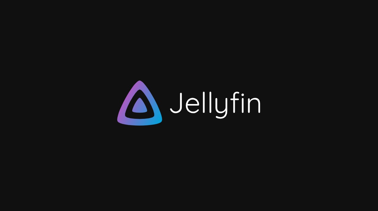

    8. I finally ran ninja and got a src\JellyfinMediaPlayer.exe for my troubles
    9. Running it failed; I had to run set "PATH=C:\Qt\5.15.2\msvc2019_64\bin;%PATH%" so the Qt DLLs are found and copy mpv\libmpv-2.dll src\ for src\JellyfinMediaPlayer.exe to start
    Now, the actual loading of JMP fails - I imagine it's looking for some resource or for more (QtWebEngine) DLLs to load at runtime l that I need to copy from elsewhere (presumably the steps to create an installer bundles everything together) - but it did build for a 64-bit system, on a 64-bit machine, using the latest 64-bit libmpv dll from shinchiro:
    [Image: nJhPnEG.jpeg]
