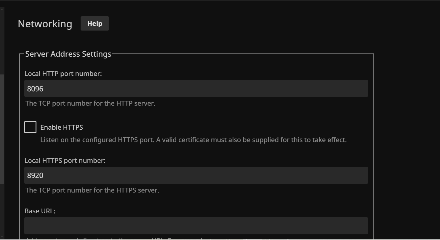

    Can you share screenshots of Dashboard > Networking?

    Hey sorry for the delay, and also for the duplicate thread! Thought I deleted this one haha. But anyway thank you so much for your help thus far!
    Tried finding loopback settings for the router, no luck with that. My router is one I was given from Spectrum (so that may part of the issue. probably should just go buy my own) with a model # of SAC2V2S. It has the lovely feature of only being able to edit its' settings from a phone app... Yet another reason I should go buy a different one lol.
    And I'll include screenshots of my Jellyfin network page to this reply also.

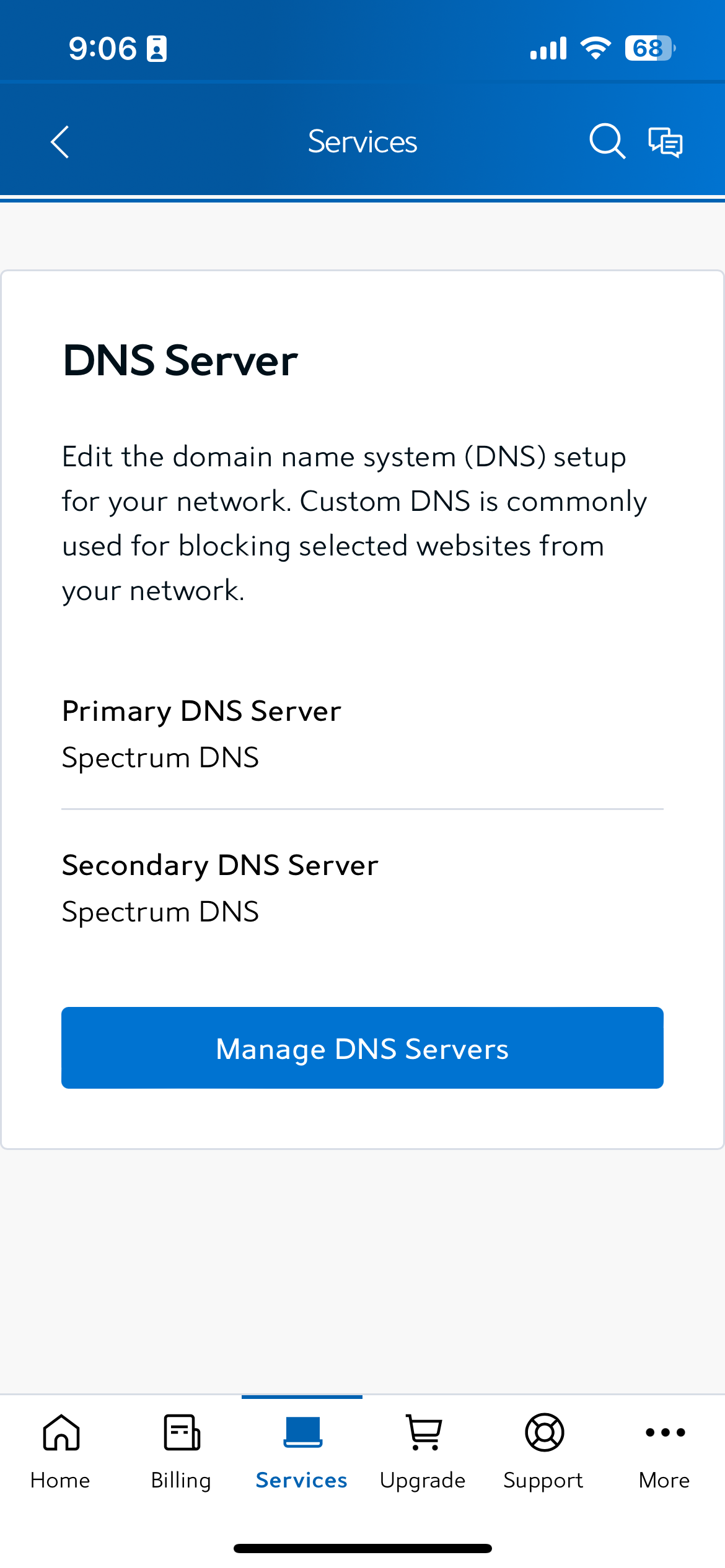

    So does my Spectrum app have limited DNS editing ability? I’m attaching pics of the only DNS menus I see. If I am on the right page, would do I enter? I guess I’m not sure even sure what type of value the prompt is looking for.
    2024-05-03, 04:23 PM
    Is the app the only way to interact with the router? Do they not allow you to access the router's admin panel from a web browser?

    2024-05-03, 04:44 PM
    (2024-05-03, 04:23 PM)TheDreadPirate Wrote: Is the app the only way to interact with the router?  Do they not allow you to access the router's admin panel from a web browser?
    Indeed.. If I attempt to go to the default IP or whatever in the browser, it just pops up a page with a QR code to go download the phone app.. 😭 I think I’ll just have to go give spectrum back their poopy router and get my own! haha
