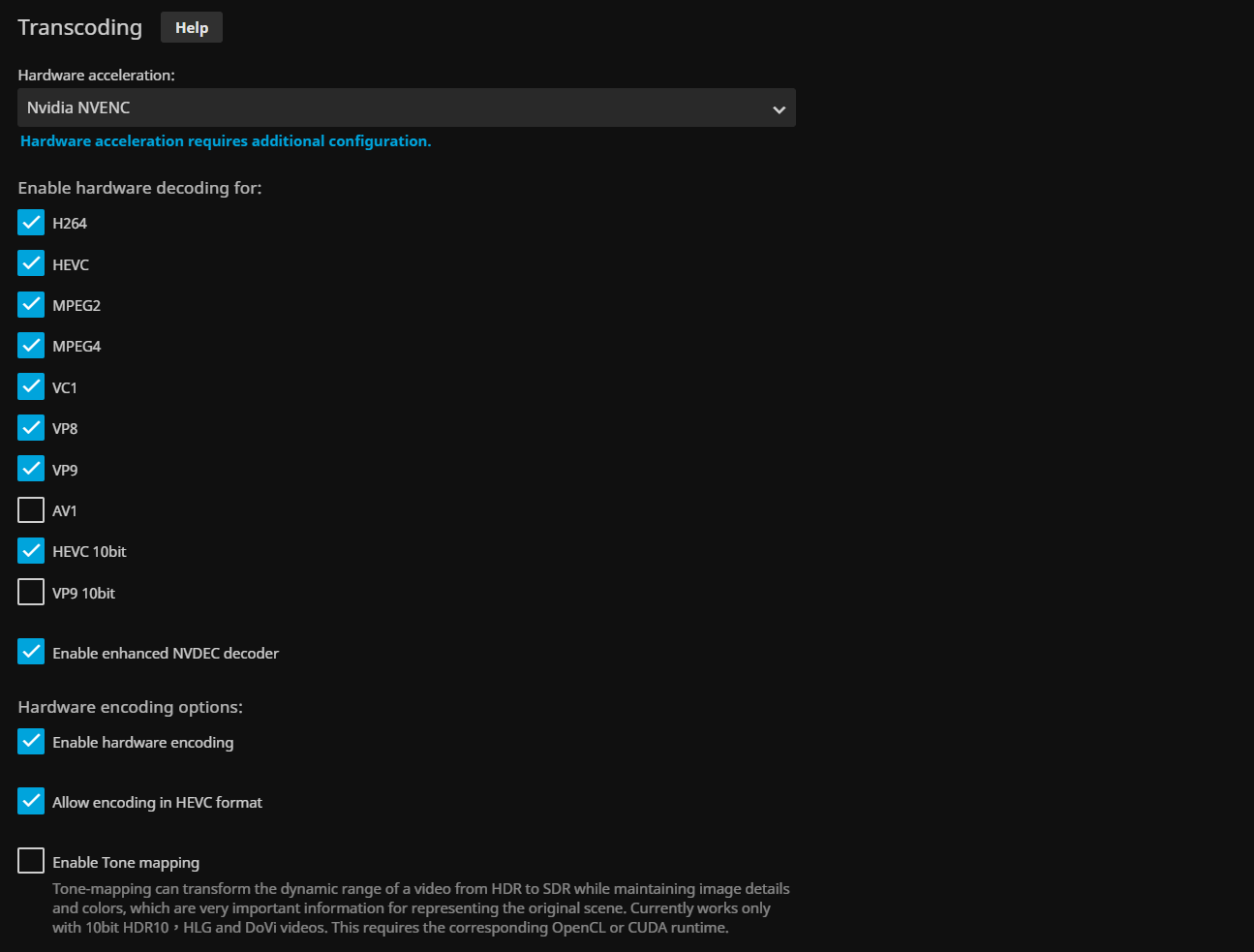

    Hi i am running debian 11 with yunohost having installed jellyfin 10.8.13 i have tried many times to set jellyfin up using nvenc but never succeeded.
    i am using an nvidia quadro P4000 with driver 550.54.14. see my transcoding settings in the attachment

    2024-03-31, 12:19 AM
    Did you install the encode/decode packages?
    https://jellyfin.org/docs/general/admini...linux-host
    sudo apt list --installed | grep libvn
    Looking for libnvcuvid1 and libnvidia-encode1. If they are not installed
    sudo apt install libnvcuvid1 libnvidia-encode1
    Nickoetje
    Posts: 9
    Joined: 2024 Mar
    Country:Netherlands
    2024-03-31, 12:25 AM (This post was last modified: 2024-03-31, 12:26 AM by Nickoetje.)
    those indeed were missing i am now still getting the error that it cant be played but the logs dotn show the missing llib arreors now they give me this
