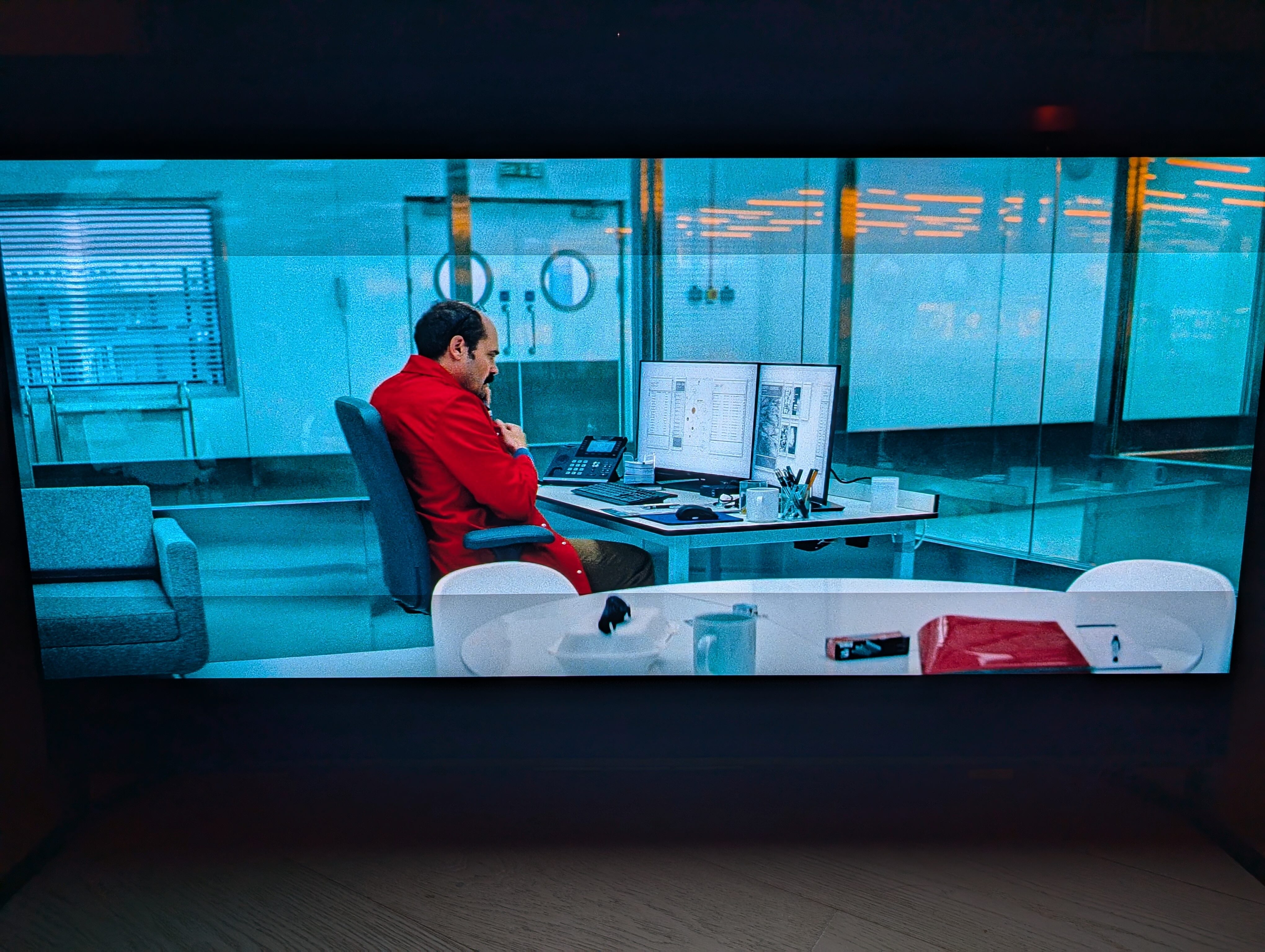

    I mean no disrespect but I'm actually not sure that is the same issue OP and I are experiencing.
    That issue seems to be about the bars at the top and bottom being grey instead of black. I find many mentions of this issue, for example this one
    https://github.com/jellyfin/jellyfin-and...ssues/3470
    Our issue is instead that there are shaded regions inside the actual movie (attaching a photo). This forum post is the only mention I find of our issue. What you wrote (about the DV metadata becoming compressed) makes sense though, so maybe this was already clear to you.
    I can confirm that the only instances I have found for this issue were with movies in 3840x1608 using Dolby Vision profile 8.1. If I turn off Dolby Vision (I use the Vimu player), then the problem goes away. The problem is there using both Vimu and Exoplayer.
    Do you still believe this is an issue only Sony can solve? If so I think I'll try writing them.
