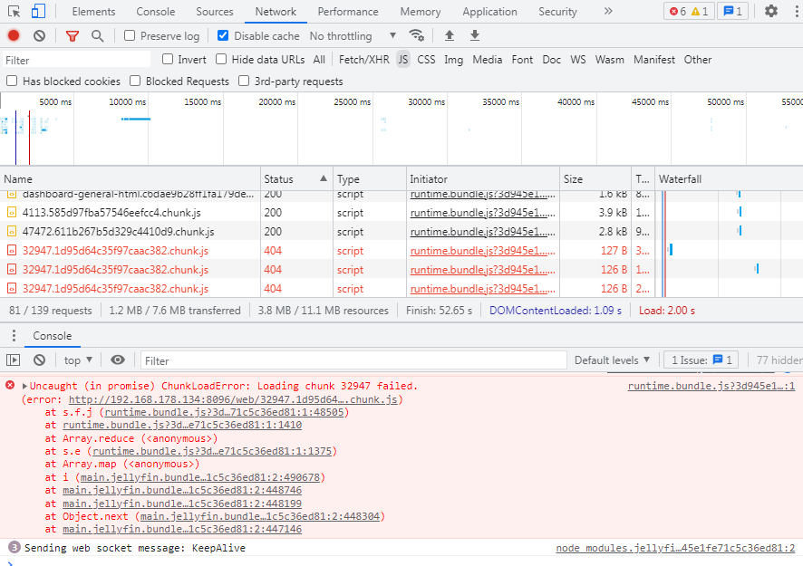

    My Dashboard is not loading after upgrade 10.9.11 -> 10.10.3
    There is allways one error, cache cleared, all sorts of browser and apps, JF reinstalled after removing jellyfin-web directory…
    GET
    xxx.xxx.134:8096/web/32947.1d95d64c35f97caac382.chunk.js
    [HTTP/1.1 404 Not Found 10ms]
    A ton of apps and OSs testet:
    On this old app (Jellyfin Media Player 1.5.0) loads the Dashboard!
    Server is running with debug log turned on, so it's huge.
    Anyone seen thiskinda thing before? What should I look/grep for in the log file?
    Any hint at all?

    Older Jellyfin Media Players included their own copy of Jellyfin-web, while versions starting with 1.10.1 used the server's jellyfin-web by default.
    What OS is your server running and can you share your jellyfin logs via pastebin?

    (2024-11-23, 07:01 PM)TheDreadPirate Wrote: versions starting with 1.10.1 used the server's jellyfin-web by default.
    Well, I'm using an older Jellyfin Media Player 1.5.0, so this would explain.
    Server is running in a jail on 13.3 and I use the standard pkg repos.
    Log is now over 22MB now, will not work with pastebin, if I remember right.
    Just a short log here, from when I was connection al these devices.
    .txt   sortlog.txt (Size: 44.71 KB / Downloads: 144)

    It seems to be an upstream issue. For more details, see here.
