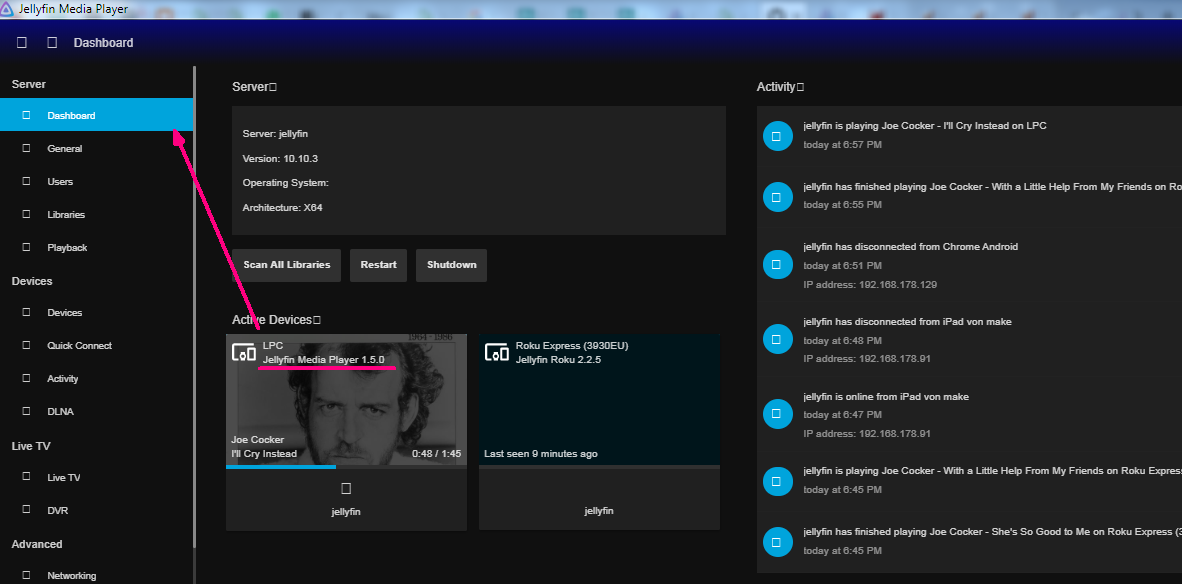

    My Dashboard is not loading after upgrade 10.9.11 -> 10.10.3
    There is allways one error, cache cleared, all sorts of browser and apps, JF reinstalled after removing jellyfin-web directory…

    A ton of apps and OSs testet:
    On this old app (Jellyfin Media Player 1.5.0) loads the Dashboard!

    2024-11-23, 07:01 PM
    Older Jellyfin Media Players included their own copy of Jellyfin-web, while versions starting with 1.10.1 used the server's jellyfin-web by default.

    2024-11-23, 10:39 PM
    (2024-11-23, 07:01 PM)TheDreadPirate Wrote: versions starting with 1.10.1 used the server's jellyfin-web by default.
    What OS is your server running and can you share your jellyfin logs via pastebin?
    Well, I'm using an older Jellyfin Media Player 1.5.0, so this would explain.
    Server is running in a jail on 13.3 and I use the standard pkg repos.
    Log is now over 22MB now, will not work with pastebin, if I remember right.
    Just a short log here, from when I was connection al these devices.
