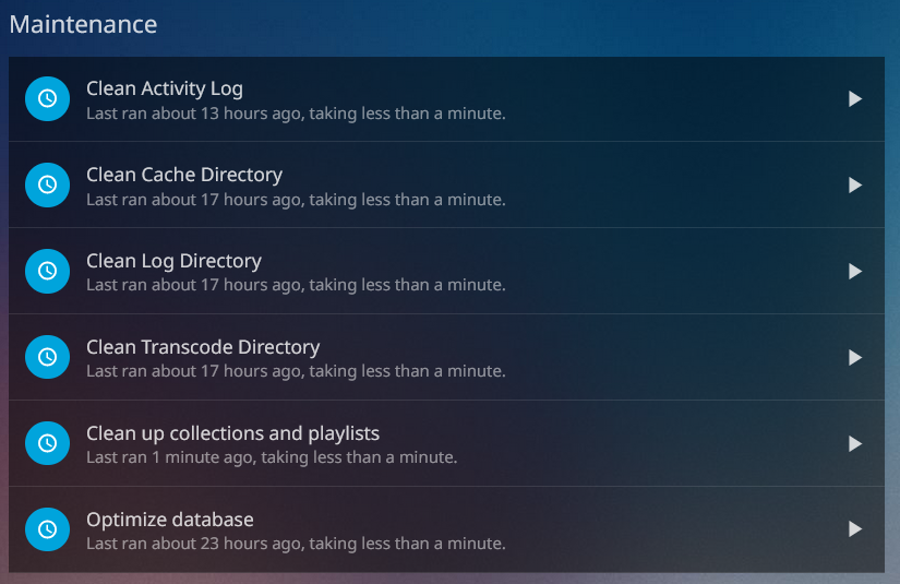

    I have a weird issue, some values in the db just refuse to update, i currently can't: remove devices (only from the proxied version), clear the activity log (both from proxied and localhost), clear the log folder (both proxied or localhost), delete users (only proxied version), remove libraries (proxied only).

    (2024-10-03, 06:20 PM)TheDreadPirate Wrote: What do you mean "clear activity log" and "clear log folder"?  AFAIK, you can't delete activity entries nor logs from the Jellyfin UI.
    The clean activity log and clear log directory scheduled task

    i managed to find a partial solution, i fixed everything that was broken on the proxied version by adding the DELETE verb to the allowed list in IIS, basically i had disabled every verb other than GET and POST for a website i host, and hadn't realized that i had done so for the entire web server.
    only these tasks remain broken, even when not using jellyfin through the proxy.

    Wait, i fixed the issues i had with the proxy, i now get the same results that i get on the non proxied site, the problem with the scheduled tasks also happens in the non-proxied version, i.e. when accessing through http://10.0.0.1:8096 (10.0.0.1 being my jellyfin server's address)
