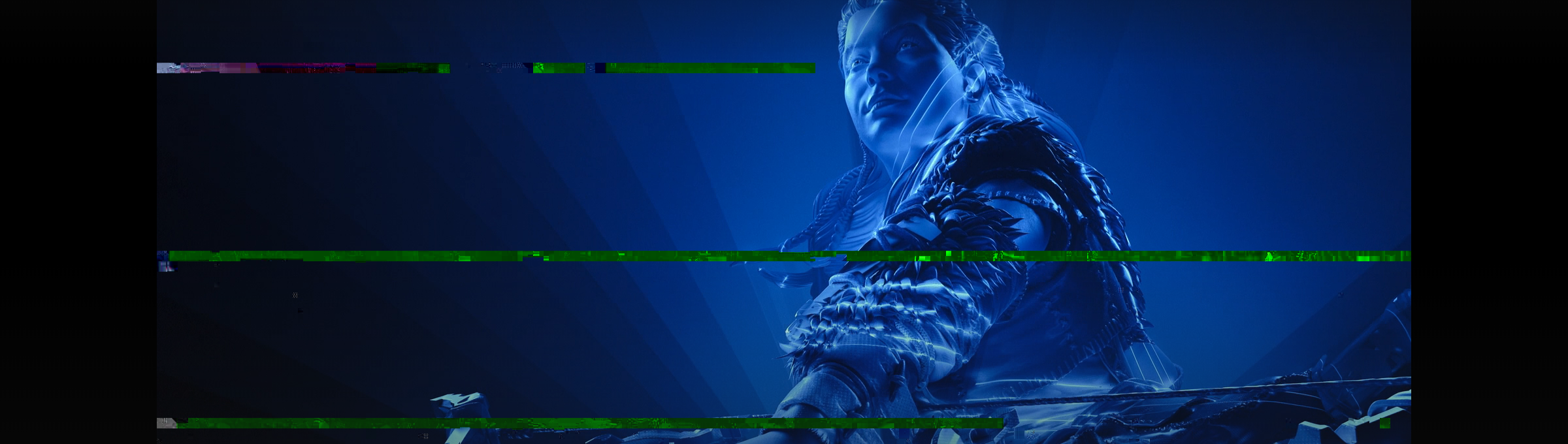

    The issue comes from when jellyfin is in direct steaming to another device and is transcodeing the audio. the video playback looks like when a dvd is barly readable. this happens to all movies and I did check them they are all good copies. This did not happen on the 19th of October worked perfectly fine. but started happening on the 20th of October no settings changed between that time. The video also happens to break in the same exact spots every time.
    Jellyfin V 10.9.11
    Roku 2.2.0 and the android client both have the exact same issue.
    Server is running on windows
    Log file

    Try playing the same video on another video player like VLC on a PC. Check to see if the video itself is not corrupted.
    2024-10-22, 08:34 PM
    To echo efficient, are the same videos you had prior to the 19th also showing this issue?

    I have tried VLC and yes the video files themself are not corrupted, and it only happens when transcodeing. Issue did not happen prior to the 19th
