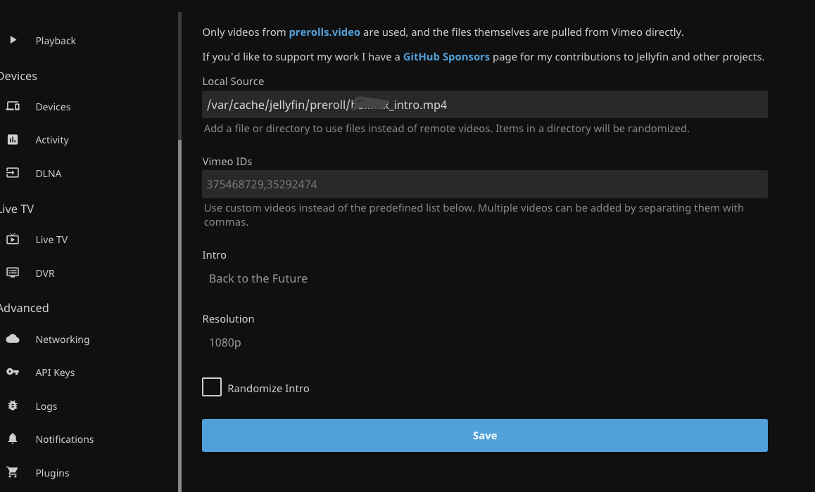

    I've created a H.264 MP4 file @1080p this morning in Davinci Resolve and exported it, I can play it locally without any issues but the problem comes when I try to set it up within the plugin.

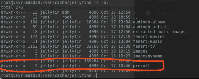

    So far, I've installed the plugin, created a new directory under /var/cache/jellyfin/, the directory is name preroll, I've ensured that the permissions and ownership of the directory is owned by the jellyfin user and have restarted the server.
    Here are my settings:

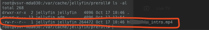

    As you can see, the file permissions seems to be correct too:
    ...and for the video file itself...

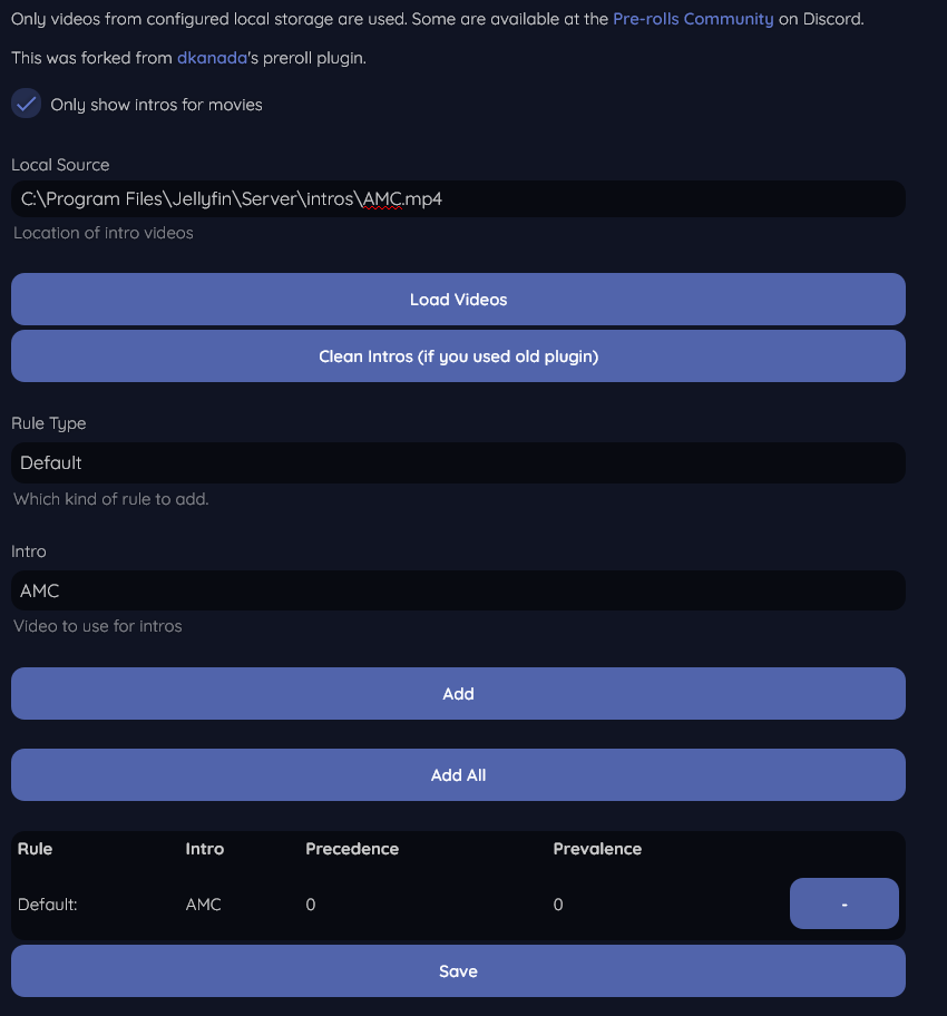

    I am having the same issues. Everything seems set up correctly. My intro mp4 file does not play at all. Movie(s) just starts.
    I am using version 3.0.0.0 of the plugin on a basic install of Jellyfin 10.9.8 on a fully updated Windows 10 machine.

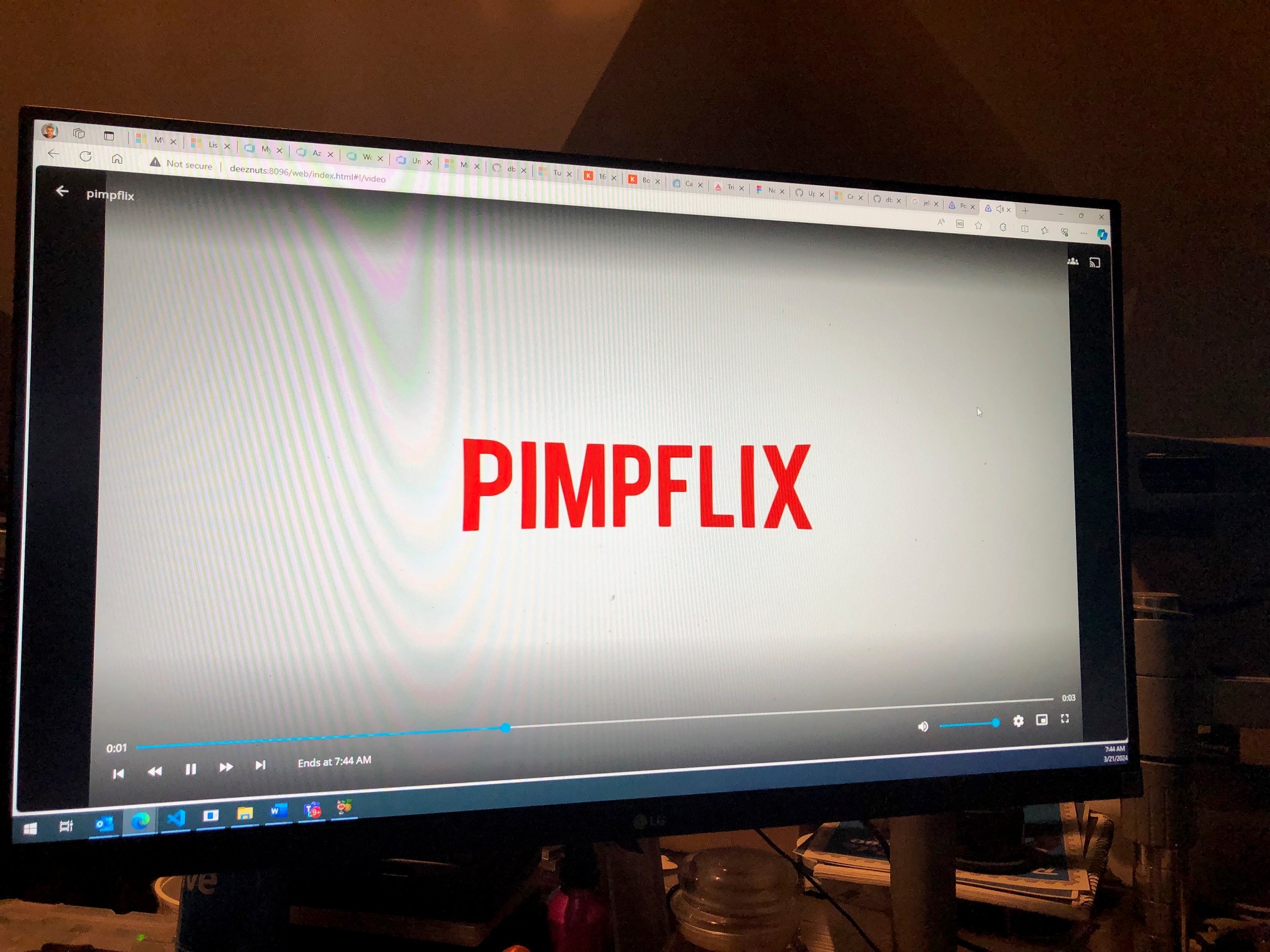

    2024-08-11, 09:00 PM (This post was last modified: 2024-08-12, 12:41 AM by AlbarranDesign. Edited 1 time in total.)
    UPDATE: It just started working for me. Maybe it was the 10.9.9 upgrade, not sure.
    UPDATE EDIT: They do not play on my AppleTV using Swiftfin.
