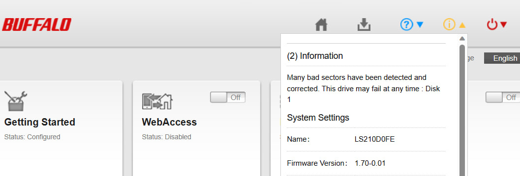

    Besides that, when I start the scan, my NAS feels unresponsive. I can barely connect to the NAS dashboard. Also, from my windows PC that I mapped the network drive to the NAS, I cannot connect to the NAS as well.
    I tried to stop the scan and stop jellyfin container, reboot the nas, then I can connect to NAS normally. But when I try to refesh/update metadata of the library, the NAS went unresponsive again.
    After a few tries, the NAS rebooted with the following notification: "Many bad sectors have been detected and corrected. This drive may fail at any time"
    When I check the disk and reboot NAS, everthing seems normal again.

    Jellyfin does not harm your NAS. Bad sectors can go undetected for a long time if the data located on that sector is not accessed. Your use of Jellyfin simply accessed sectors that hadn't been accessed in a while and revealed the problem.
    Depending on whether it is a physical or logical bad sector, it may be possible for the hard drive to work around the bad sectors. Once a hard drive starts to report bad sectors, usually, more will follow. I wouldn't take that risk with my data and neither should you.
    Backup your data ASAP and replace the hard drive associated with that message.
