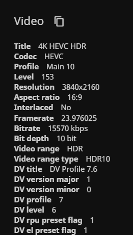

    How do I use ffmpeg to encode with HEVC Main10/10-bit? This parameter is supposed to work, but I know that placement within the command is important and I don't know where that is.
    -profile:v main10
    /usr/lib/jellyfin-ffmpeg/ffmpeg \
                    -init_hw_device vaapi=va:,driver=iHD,kernel_driver=i915 \
                    -init_hw_device qsv=qs@va \
                    -filter_hw_device qs \
                    -hwaccel qsv \
                    -hwaccel_output_format qsv \
                    -i "$inputFile" \
                    -map 0:v \
                    -map 0:a \
                    -map 0:s \
                    -map_chapters 0 \
                    -c:v hevc_qsv \
                    -preset slower \
                    $hdrProfile \   <------ profile:v main10 goes here if I run my script and specify it is HDR.
                    -pix_fmt nv12 \
                    -c:a copy \
                    -c:s copy \
                    -ss $startTime \
                    -to $endTime \
                    -global_quality:v $quality \
                    -vf "$filters" \
                    "$outputFile"

    In my experience, the placement matters for certain things, less for others. The profile never seemed to matter as long as it was in the correct block. If you're getting errors, try changing your pixel format.
    The pixel format you have, nv12 is the qsv equivalent of yuv420p, which is 8-bit. The qsv equivalent of 10-bit (yuv420p10le) is p010le. Change these two lines:
    -profile:v main10
    -pix_fmt p010le

    That was it.  Thanks!
