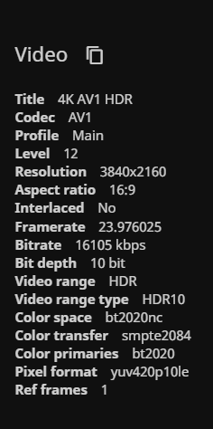

    @bitmap How does HDR and 10 bit color work with AV1?  I can't find documentation about AV1 profiles, like main vs main10 in HEVC.  One of my HDR10 test encodes appears to have automatically used 10 bit color without my having to specify that during the encode.  Does AV1 automatically do that?

    2023-11-13, 12:26 AM (This post was last modified: 2023-11-13, 12:28 AM by bitmap. Edited 1 time in total.)
    Depends on the encoder. If we're talking av1_qsv, I've found that currently only 8->8 and 10->10 works properly. Everything else gives me an error. So that's dependent upon source and is automatic. By default, if you're doing a one-for-encode without mapping anything, any necessary metadata should come over with the encode automatically and the doesn't appear to be a flag like with SVT-AV1.
    So in my experience, it's almost automatic. When mapping streams, you need to ensure that you map the metadata correctly in most cases, which I'm still struggling with a bit. I haven't had a single AV1 encode with HDR fail, though without the metadata I have had encodes fail to play properly.
    On profiles/levels: they don't work the same as HEVC. Profile should be main for nearly everything, as I think the next up is professional? Run ffmpeg -h encoder=av1_qsv for more details about what options are available. Note that a lot of things are broken at the moment.
