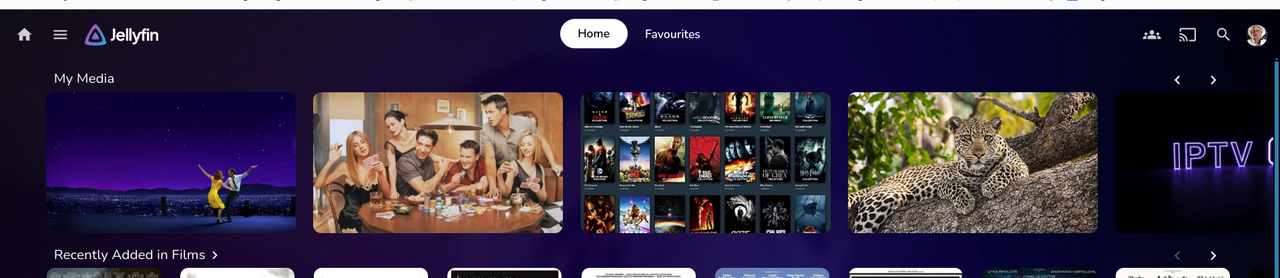

    and the other thing, is that I keep the display problem, even using the normal spotlight.html file, it gives me that unused blank space between the bar and my media.
    [Image: 3mTMAeM.png]
    Thinking that maybe it was an incompatibility with the theme I had, I put finimalism as well without any css and still the problem, plus it seems to crop the photos and the text/logo of the movies (word Sonríe cutted in half)
    [Image: 0yRt92H.png]
    the weirdest thing is that in the mobile version it works flawlessly, without any problem.

    (2024-11-21, 04:20 AM)Drake97 Wrote: and the other thing, is that I keep the display problem, even using the normal spotlight.html file, it gives me that unused blank space between the bar and my media.
    could it be maybe that I am doing all the tests on my monitor which is 2k instead of 1080p ? if so I apologize as I don't have a lower resolution monitor to test on
    if you want we can communicate by discord or some other way, for me to be working as a kind of QA or something like that, only if you think so
    greetings
    greetings

    my man!!,
    for some reason my chunk.js had much less information than the one you gave me and after making a backup of mine, replace it with yours, it works perfectly, I no longer have that lost space and the bar works 10 of 10, thank you very much Grinning-face

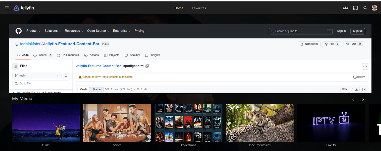

    Hi,
    after editing the relevant files to the letter as per the instructions on Github and checking the above instructions for linux, still no dice.
    On Chrome the frame does not even appear:
    [Image: Capture-d-cran-du-2024-11-23-11-33-31.png]
    On Firefox I get this :
    [Image: Capture-d-cran-du-2024-11-23-11-32-54.png]
    I am stumped and need some help.
    TIA

    I think, in the instructions where it said path/to/spotlight.html, you put the internet address, it should be the local address of where it had downloaded (I'll make the guide more specific if this is what happened)

    Ok basically on the github page, it just said "Download [spotlight.html]" and I think a lot of people will just right-click the link and Save As... rather than going to the file page and downloading. So they end up downloading the github page instead of spotlight.html.  Is that maybe what happened? I've edited the guide now

    (2024-11-24, 05:09 PM)Ted Hinklater Wrote: Ok basically on the github page, it just said "Download [spotlight.html]" and I think a lot of people will just right-click the link and Save As... rather than going to the file page and downloading. So they end up downloading the github page instead of spotlight.html.  Is that maybe what happened? I've edited the guide now
    That was it! Two things though, the whole interface is noticeably less responsive with the beautiful theming (my oudated rig?) and I don't see the placeholder for trailers in the frame. Anything I can do about that?
