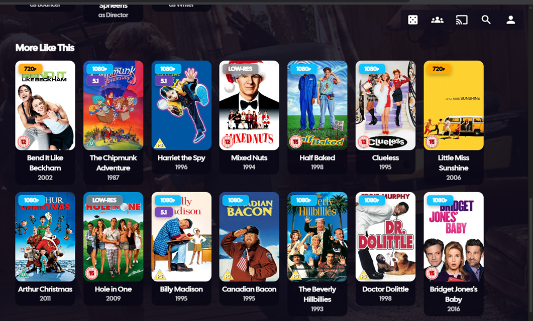

    basicly ive been trying to copy your title page style, so I can use a custom code to get the same design as your, background image, movies poster on the left and large logo in the middle, ive tried it with my own code, but I endup breaking the mobile view and profiles as you can see in the images. so I was wondering how you manged to do it without breaking the other code. it inadvertently breaks mobile.
    the problem with Jellyfin is the mobile schema and desktop schema shares elements so its finding the balance of 1 config that wont damage multiple platforms.
    If you need the code ill DM you the code or share on here.
    also I think I think @import url("https://cdn.jsdelivr.net/gh/tedhinklater/finimalism@main/no-animation.css"); is not working, unless it only my side, I have tried another browser. but nothing changes. image attached of what i see, unable to move it down.

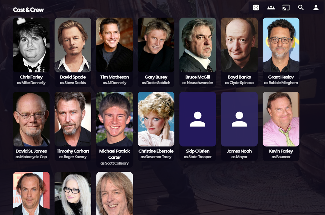

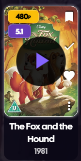

    Thanks,  This title page looks how I wanted, I want to add the modern updates. I'm not sure of all the changes from this to the latest update. if you could share.
    but here are 4 that is did notice and wanted to update.
    1. The Play control, update and custom colours
    2. switch from scrolling to show all, in the title pages and media page.
    Could you share the CSS please
    images attached to help understand
