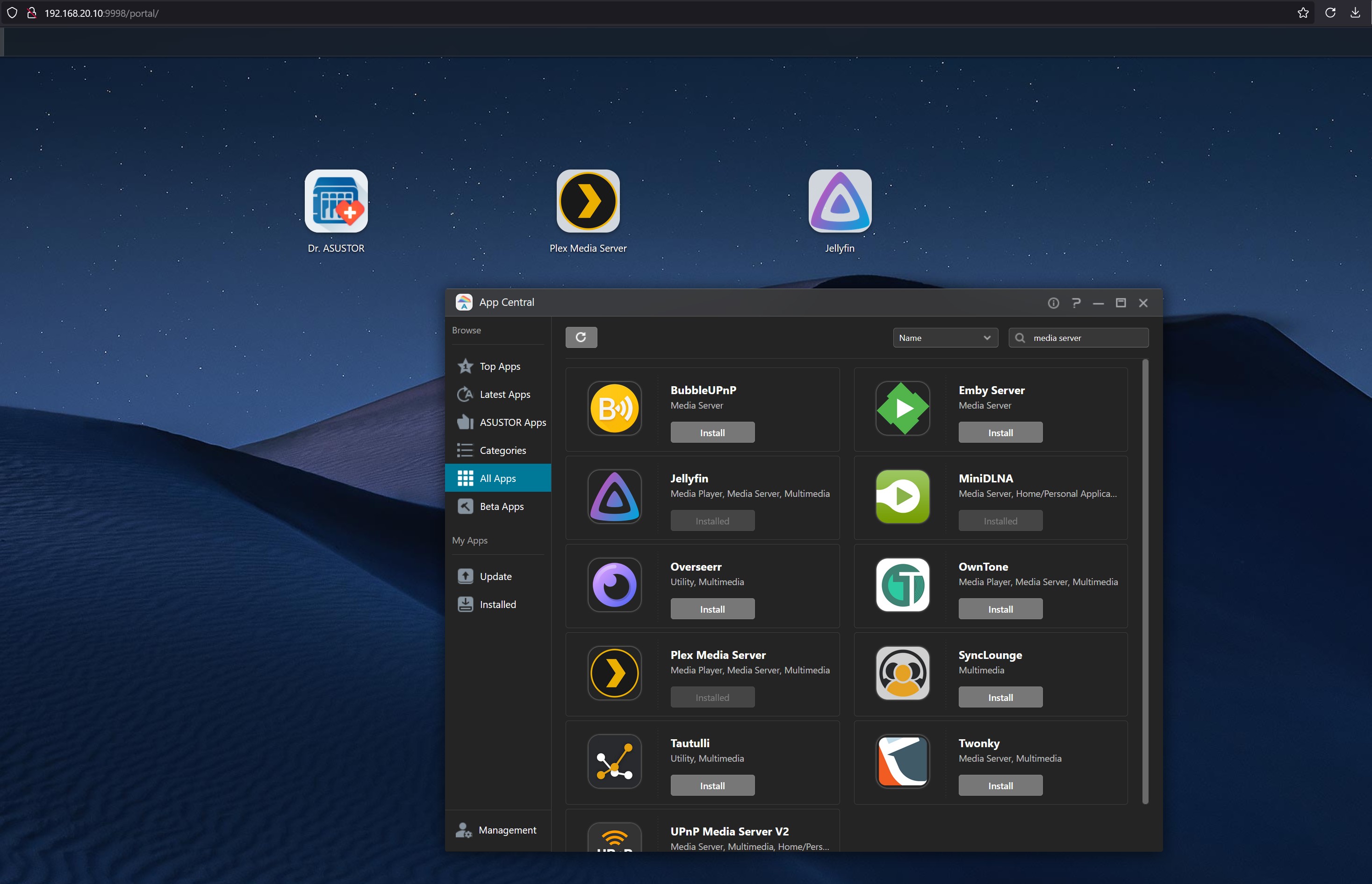

    NAS has a useful OS/Dashboard with ability to load and configure apps/plugins as per the screenshot. Not sure, but I think it is setup as host?
