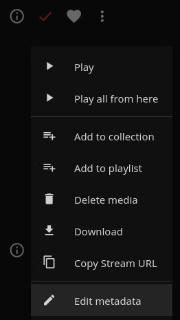

    Edit the item using the kebab menu (three vertical dots) > Edit Metadata.
    Change what you want, remove any excess data that might cause issues, and then you need to lock the item. This option is at the bottom of the metadata editor modal.
