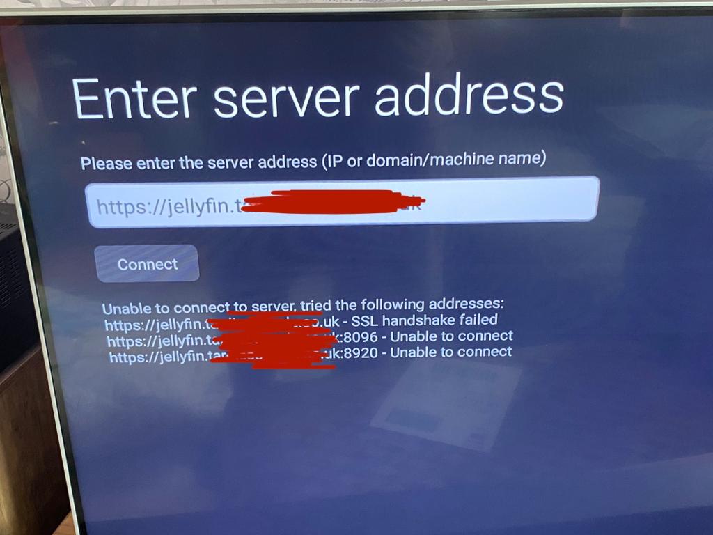

    Hi.
    Attached screenshot.
    So my setup is on a Synology DS218+, with a reverse proxy for HTTPS.
    I've added the URL to the known proxies box.
    Everything works fine on everything BUT the app from the play store, on my Google TV.
    Using my iPhone Jellyfin app, Infuse, direct to HTTPS url works absolutely fine.
    On the Google TV app, it will also work fine for a discovered IP locally.
    However, when I enter the external HTTPS address (again, that works fine on other apps and direct in a browser), I get the error "SSL handshake failed.
    What could the issue be?
    With the screenshot, the error is correct for the other ports, as the reverse proxy URL redirects 443 to 8090, then another reverse proxy redirects 8090 to 8096.
    8096 won't work because I have https in the URL, but does work if I use http.
    I've tried getting 8920 to work and have converted my crt and txt to a pfx file, put in the password that I entered during the conversion, but HTTPS does not seem to load or work?
    I've also put at the end of the URL :8090, but I get the same SSL Handshake failed error.
    Thanks a lot!

    Is it a self-signed certificate?

    I somehow managed to fix this by re-converting my crt and txt to a pfx and pointing jellyfin to it again.
    Once https was enabled, it for whatever reason worked, even though my reverse proxy already had https..
