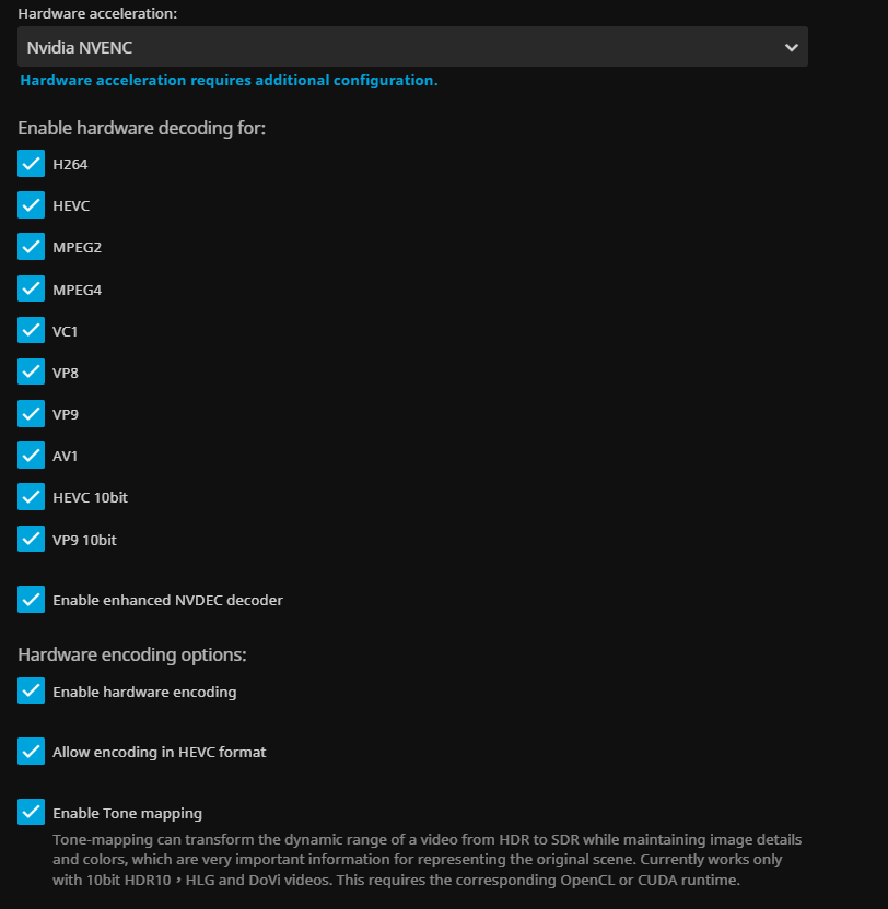

    I am just trying Jellyfin for the first time and my GPU tends to keep maxing out with hardware acceleration (NVENC) on. I have an RTX 3070, I turned on hardware acceleration as without it my CPU was maxing out (Ryzen 5 3600). I am unsure why this happens, but due to this video will keep freezing up when streaming. Any help would be appreciated!

    What does your hardware accelleration configuration look like?

    I attached a photo of the hardware acceleration, other than what is in the photo, the rest was left to default. I am unsure how to fine the FFmpeg transcoding log, sorry I am new to all of this...

    Your CPU can’t keep up with such a fast GPU. The throttle transcoding feature can be enabled to limit the transcoding speed, or you can change the encoding quality preset to slow.

    Even with the throttle on GPU is still maxing out.
    Edit: I did more testing, it appears this did fix GPU maxing out overall, with only occasional spikes to 100%. But if I watch jellyfin from the same computer I host it on the video still skips and the gpu will still max out.

    Each time Jellyfin is transcoding (which is a pretty bursty process) it takes resources away from video playback for a short interval. Smooth video playback requires very consistent frame times and transcoding 4K HDR is both a CPU and GPU intensive process.
    What is it like watching Jellyfin on another device?

    On other devices, even when on multiple watching different shows and/or movies, the playback is smooth. When I watch on the device the server is hosted from, playback (only on that device) is quite choppy and consistently freezes.
    2023-07-08, 04:11 PM
    I'm going to double down and say that this is not unexpected. Do the logs say why it is transcoding when playing locally? I would assume if it can transcode a video that it would also be able to direct play the video.
