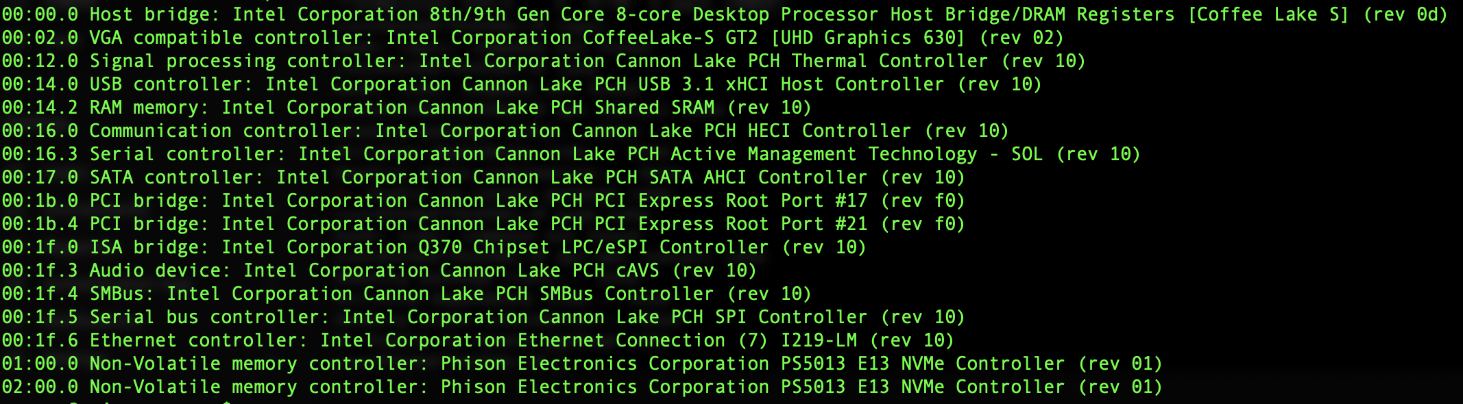

    Hi There,
    I'm running Jellyfin on linux docker with linuxerver jellyfin version. 10.8.13-1-ls2.
    My docker run command is attached. I've also attached the lspci response on the host (green) and the docker container (black & white).
    I keep facing an issue with the following error:
    No VA display found for any default device.
    Device creation failed: -22.
    Failed to set value 'vaapi=va:,kernel_driver=i915,driver=iID' for option 'init_hw_device': Invalid argument
    I have an image with the full output below.
    Whenever I enable hardware encoding I get these errors the video fails to play.
    Has anyone faced this issue before? Maybe I am enabling the wrong kinds of media to transcode. I've checked and I think this configuration should work.
    Thank you

    I had this issue recently. I discovered that for some reason my /dev/dri directory was empty. I'd have to do some digging to figure out what exactly I did to solve it, but it might be worth running ls /dev/dri on the host machine to make sure renderD128 and card0 are in that directory.

    (2024-03-07, 05:33 PM)kandykarter Wrote: I had this issue recently. I discovered that for some reason my /dev/dri directory was empty. I'd have to do some digging to figure out what exactly I did to solve it, but it might be worth running ls /dev/dri on the host machine to make sure renderD128 and card0 are in that directory.
    I have them in the container with full permissions. Odd
