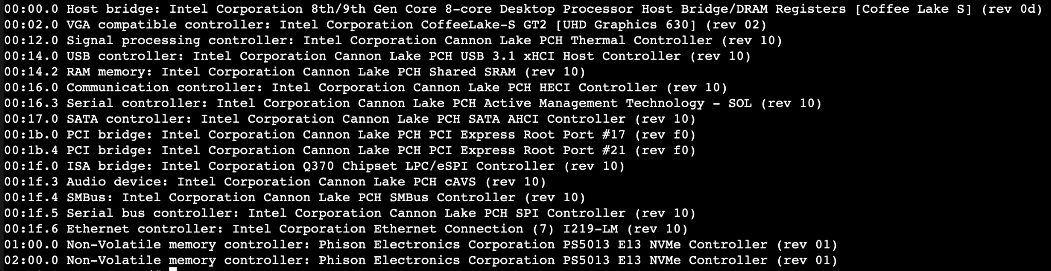

    Hi There,
    I'm running Jellyfin on linux docker with linuxerver jellyfin version. 10.8.13-1-ls2.
    My docker run command is attached. I've also attached the lspci response on the host (green) and the docker container (black & white).

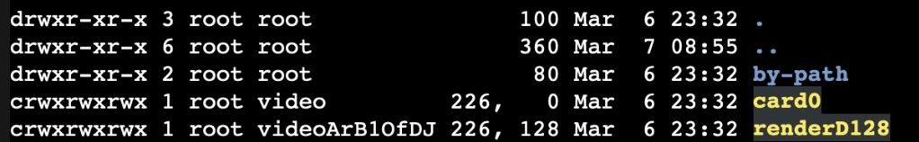

    I had this issue recently. I discovered that for some reason my /dev/dri directory was empty. I'd have to do some digging to figure out what exactly I did to solve it, but it might be worth running ls /dev/dri on the host machine to make sure renderD128 and card0 are in that directory.

    (2024-03-07, 05:33 PM)kandykarter Wrote: I had this issue recently. I discovered that for some reason my /dev/dri directory was empty. I'd have to do some digging to figure out what exactly I did to solve it, but it might be worth running ls /dev/dri on the host machine to make sure renderD128 and card0 are in that directory.
    I have them in the container with full permissions. Odd
