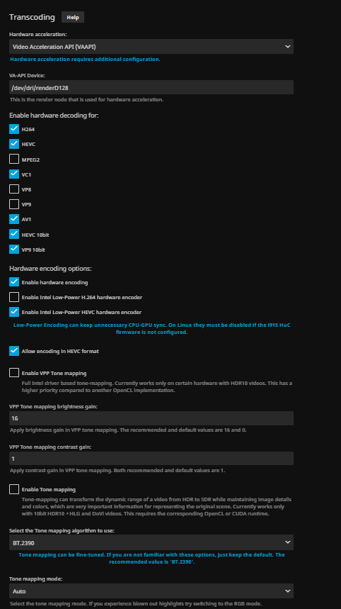

    Whenever trying to play HEVC format for chrome browser on my PC, getting this error: Playback Error
    This client isn't compatible with the media and the server isn't sending a compatible media format.
    Also tried both Intel quick sync and video acceleration API but nothing works
    I have checked off the HEVC decoding but still wont work.
    Any suggestion would be help full, thanks

    You should be using QSV instead of VA-API when using Intel graphics

    2024-01-22, 02:50 PM
    You also have too many of those codec boxes checked.
    https://en.wikipedia.org/wiki/Intel_Quic...d_encoding
    MPEG2
    H264
    VC-1
    VP8
    VP9?

    @TheDreadPirate thanks for sharing the wiki my cpu falls under broadwell family and HEVC is NO on the table what dos that mean ?

    "thanks for sharing the wiki my cpu falls under broadwell family and HEVC is NO on the table what dos that mean ? "
    unselect everything under hardware decoding, only select things that your gpu supports, the wiki link does not show capabilities for broadwell so you will have to source your own information
    unselect hevc encoding, broadwell is unlikely to be capable but when you find your gpu specs you can verify
    lastly fix the typo, nothing is going to work when you passed it as /dev/dir; it needs to be /dev/dri
    here i found your specs
    https://www.cpu-monkey.com/en/igpu-intel...phics_6000
    under the table hardware codec support, your gpu only supports h264 encoding
    supports h264, vp8, vc-1 and jpeg decoding

    (2024-01-22, 10:28 AM)Prince3739 Wrote:     devices:
          - /dev/dri: /dev/dir
    Is the "/dev/dir" at the end a typo?
    (2024-01-22, 04:53 PM)Prince3739 Wrote: my cpu falls under broadwell family and HEVC is NO on the table what dos that mean ?
    This means that the iGPU doesn't support HEVC.
    I looked at the codec support table for your iGPU (with Quick Sync, hopefully these also apply for VAAPI).
    Enable these:
    1. H.264
    2. MPEG-2
    3. VC1
    4. VP8
    5. VP9 (depends on linux, disable this too if unsure)
    Disable these (don't work with your iGPU):
    1. HEVC
    2. AV1
    3. HEVC 10-bit
    4. VP9 10-bit
    The ones that you will have disabled will fall back onto the CPU.
    That is, when you attempt to stream a HEVC video on a client that wont support it, your Jellyfin server will use the CPU instead of the iGPU to transcode it.
