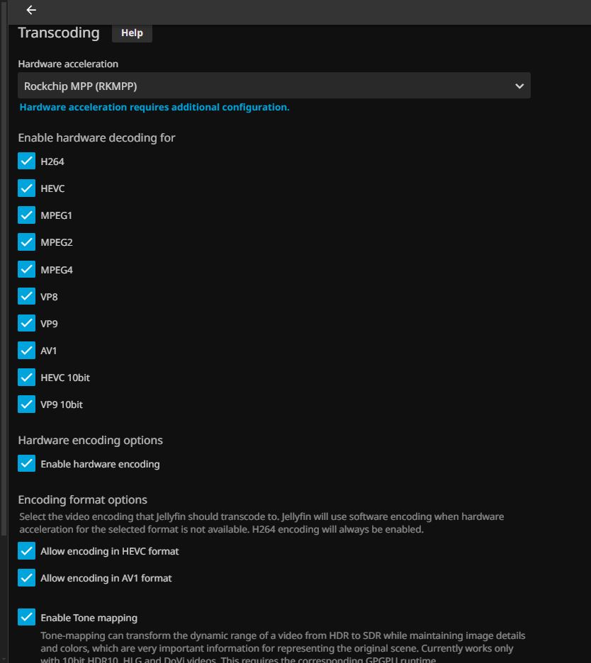

    Can you share screenshots of your transcode settings in Dashboard > Playback?

    @TheDreadPirate
    There is a screenshot of the transcoding settings.
