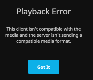

    Hi!
    I have AMD 5600G cpu and would like to use hardware transcoding.
    I can watch any movie only when selected in Hardware acceleration: None, but when I select Video Acceleration API (VAAPI) and VA-API Device: dev/dri/renderD128 I will get error for some movies “This client isn't compatible with the media, and the server isn't sending a compatible media format.”

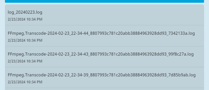

    Also I can see next exception logs:
    From one I can see
    Quote:/usr/lib/jellyfin-ffmpeg/ffmpeg -analyzeduration 200M -init_hw_device vaapi=va:/dev/dri/renderD128 -init_hw_device opencl=ocl:.0,device_vendor="Advanced Micro Devices" -filter_hw_device ocl -autorotate 0 -i file:"/data/tvshows/True.Detective.S04.2160p.HDR.DV.NewComers/True.Detective.S04E02.2160p.HDR.DV.NewComers.mkv" -map_metadata -1 -map_chapters -1 -threads 0 -map 0:0 -map 0:2 -map -0:s -codec:v:0 h264_vaapi -rc_mode VBR -b:v 37979453 -maxrate 37979453 -bufsize 75958906 -force_key_frames:0 "expr:gte(t,0+n_forced*3)" -flags:v -global_header -vf "setparams=color_primaries=bt2020:color_trc=smpte2084:colorspace=bt2020nc,scale=trunc(min(max(iw\,ih*a)\,min(3840\,1920*a))/2)*2:trunc(min(max(iw/a\,ih)\,min(3840/a\,1920))/2)*2,format=yuv420p10le,hwupload=derive_device=opencl,tonemap_opencl=format=nv12:p=bt709:t=bt709:m=bt709:tonemap=bt2390:peak=100:desat=0,hwdownload,format=nv12,hwupload_vaapi" -codec:a:0 libfdk_aac -ac 2 -ab 384000 -af "volume=2" -copyts -avoid_negative_ts disabled -max_muxing_queue_size 2048 -f hls -max_delay 5000000 -hls_time 3 -hls_segment_type mpegts -start_number 0 -hls_segment_filename "/config/data/transcodes/5b9203bdc4d13c71d16943c5a77c2213%d.ts" -hls_playlist_type vod -hls_list_size 0 -y "/config/data/transcodes/5b9203bdc4d13c71d16943c5a77c2213.m3u8"

    And from another log file I can see next:
    Quote:[2024-02-23 22:34:38.781 +02:00] [INF] [62] Jellyfin.Api.Helpers.MediaInfoHelper: StreamBuilder.BuildVideoItem( Profile="Anonymous Profile", Path="/data/tvshows/True.Detective.S04.2160p.HDR.DV.NewComers/True.Detective.S04E02.2160p.HDR.DV.NewComers.mkv", AudioStreamIndex=null, SubtitleStreamIndex=null ) => ( PlayMethod=Transcode, TranscodeReason=VideoCodecNotSupported, AudioCodecNotSupported ) "media:/videos/8807993c-781c-20ab-b388-84963928dd93/master.m3u8?MediaSourceId=8807993c781c20abb38884963928dd93&VideoCodec=h264&AudioCodec=aac,mp3&AudioStreamIndex=2&VideoBitrate=139616000&AudioBitrate=384000&MaxFramerate=23.976025&api_key=<token>&TranscodingMaxAudioChannels=2&RequireAvc=false&Tag=759314ece71650f67a6beb119914cc31&SegmentContainer=ts&MinSegments=1&BreakOnNonKeyFrames=True&hevc-level=153&hevc-videobitdepth=10&hevc-profile=main10&TranscodeReasons=VideoCodecNotSupported,%20AudioCodecNotSupported"
    [2024-02-23 22:34:39.257 +02:00] [INF] [59] Jellyfin.Api.Controllers.DynamicHlsController: Current HLS implementation doesn't support non-keyframe breaks but one is requested, ignoring that request
    [2024-02-23 22:34:39.259 +02:00] [INF] [59] Jellyfin.Api.Helpers.TranscodingJobHelper: "/usr/lib/jellyfin-ffmpeg/ffmpeg" "-analyzeduration 200M -init_hw_device vaapi=va:/dev/dri/renderD128 -init_hw_device opencl=ocl:.0,device_vendor=\"Advanced Micro Devices\" -filter_hw_device ocl -autorotate 0 -i file:\"/data/tvshows/True.Detective.S04.2160p.HDR.DV.NewComers/True.Detective.S04E02.2160p.HDR.DV.NewComers.mkv\" -map_metadata -1 -map_chapters -1 -threads 0 -map 0:0 -map 0:2 -map -0:s -codec:v:0 h264_vaapi -rc_mode VBR -b:v 37979453 -maxrate 37979453 -bufsize 75958906 -force_key_frames:0 \"expr:gte(t,0+n_forced*3)\" -flags:v -global_header -vf \"setparams=color_primaries=bt2020:color_trc=smpte2084:colorspace=bt2020nc,scale=trunc(min(max(iw\,ih*a)\,min(3840\,1920*a))/2)*2:trunc(min(max(iw/a\,ih)\,min(3840/a\,1920))/2)*2,format=yuv420p10le,hwupload=derive_device=opencl,tonemap_opencl=format=nv12:p=bt709:t=bt709:m=bt709:tonemap=bt2390:peak=100:desat=0,hwdownload,format=nv12,hwupload_vaapi\" -codec:a:0 libfdk_aac -ac 2 -ab 384000 -af \"volume=2\" -copyts -avoid_negative_ts disabled -max_muxing_queue_size 2048 -f hls -max_delay 5000000 -hls_time 3 -hls_segment_type mpegts -start_number 0 -hls_segment_filename \"/config/data/transcodes/5b9203bdc4d13c71d16943c5a77c2213%d.ts\" -hls_playlist_type vod -hls_list_size 0 -y \"/config/data/transcodes/5b9203bdc4d13c71d16943c5a77c2213.m3u8\""
    [2024-02-23 22:34:41.916 +02:00] [ERR] [56] Jellyfin.Api.Helpers.TranscodingJobHelper: FFmpeg exited with code 1

    Could anyone help me how to solve it?

    Already and was able to fix it only by using latest unstable version: linuxserver/jellyfin:nightly-version-20231115.15-unstable.
    It seems working now. Thanks.
