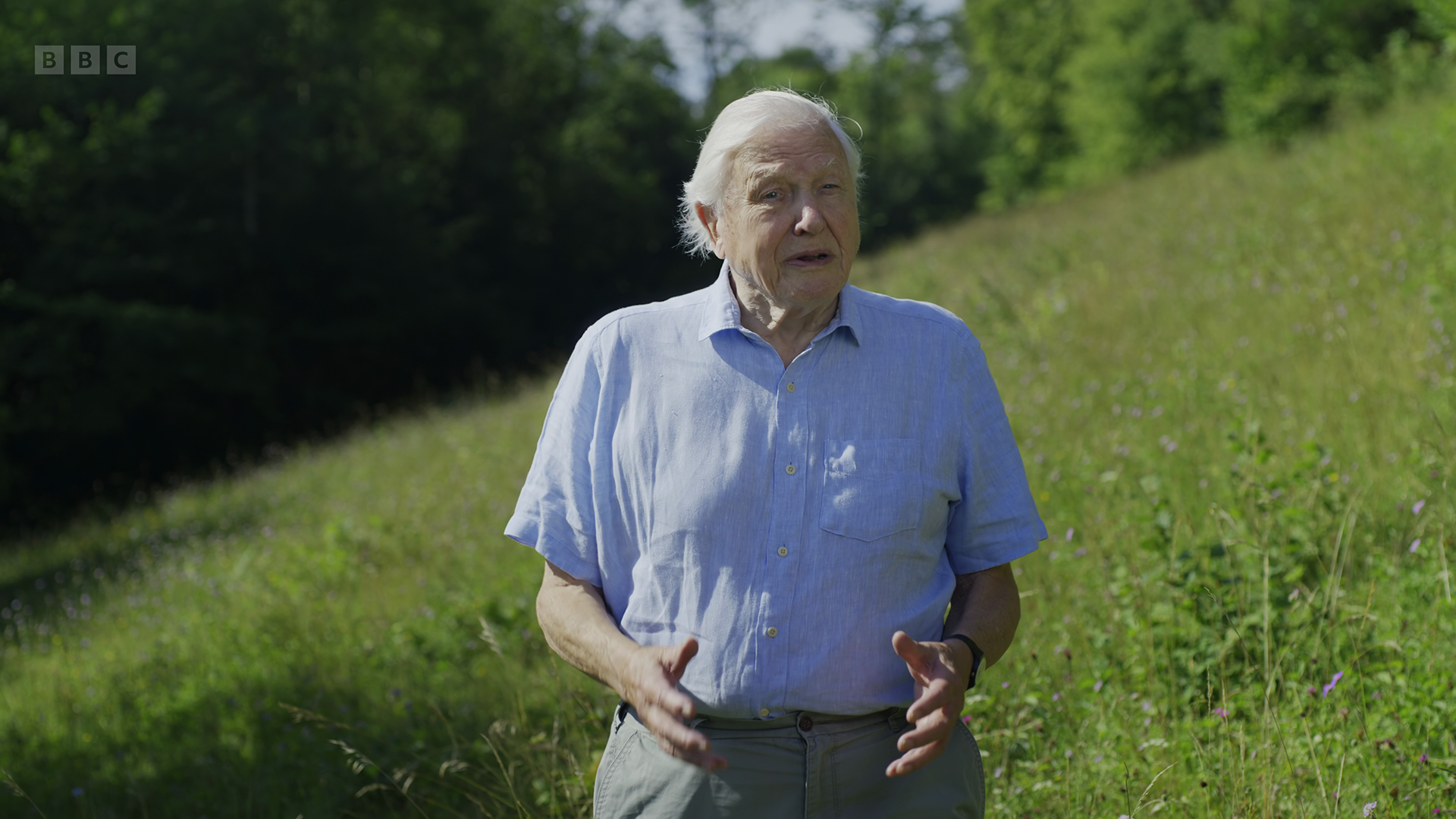

    Hello, I have an issue where tone mapping is very dark. It has generally worked well, but I noticed this particular video the image is very dark. The first screenshot is from Jellyfin. The second is from VLC. I am playing the video in Chrome browser, because the device I am playing on cannot handle decoding 4K HVEC at the moment. I used these settings for tone mapping from a post I found online that recommended them to increase the brightness. I am not sure if tone mapping is imperfect, and the best is to use the source that the output device supports, eg in this case SDR would be best.
    Is this normal behavior for Jellyfin? Would it be better if I used Apple TV to play? My TV supports HDR, but not Dolby Vision. Either way, it would be nice to have it convert to SDR in a viewable format. Thanks.

    I think its because the HDR Format is HLG. I'm pretty sure i have the same file (Planet Earth 3) and noticed the same thing yesterday. It direct plays on my LGTV perfectly but when transcoded to H264 i get the dark image like you have here. This doesn't happen on other DolbyVision/HDR content, i'm using an Arc380 so it seems its happening on multiple hardware.

    (2023-10-24, 11:34 PM)toytown Wrote: I think its because the HDR Format is HLG.  I'm pretty sure i have the same file (Planet Earth 3) and noticed the same thing yesterday.  It direct plays on my LGTV perfectly but when transcoded to H264 i get the dark image like you have here.  This doesn't happen on other DolbyVision/HDR content, i'm using an Arc380 so it seems its happening on multiple hardware.
    Thanks, that is good to know. Sounds like I should use the TV's native player (which sounds like is a whole other ordeal to install on older LG TVs).

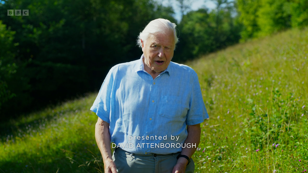

    Thank you. Video looks beautiful now (using 6.x).
    Is there any advantage to using the older ffmpeg over version 6?

    (2023-11-04, 02:29 AM)xilex Wrote: Thank you. Video looks beautiful now (using 6.x).
    [Image: SbdvyQe.png]
    For NVIDIA users, with the enablement of the AV1 encoder in FFmpeg 6.0, a driver update is mandatory.
    Therefore, we have not enabled FFmpeg 6.0 in JF 10.8.x for the time being but postponed it to JF 10.9.
    Quote:NVENC headers are updated to meet the requirement of NVENC AV1 encoder, the minimum required NVIDIA driver versions have been changed to 520/522 series.
