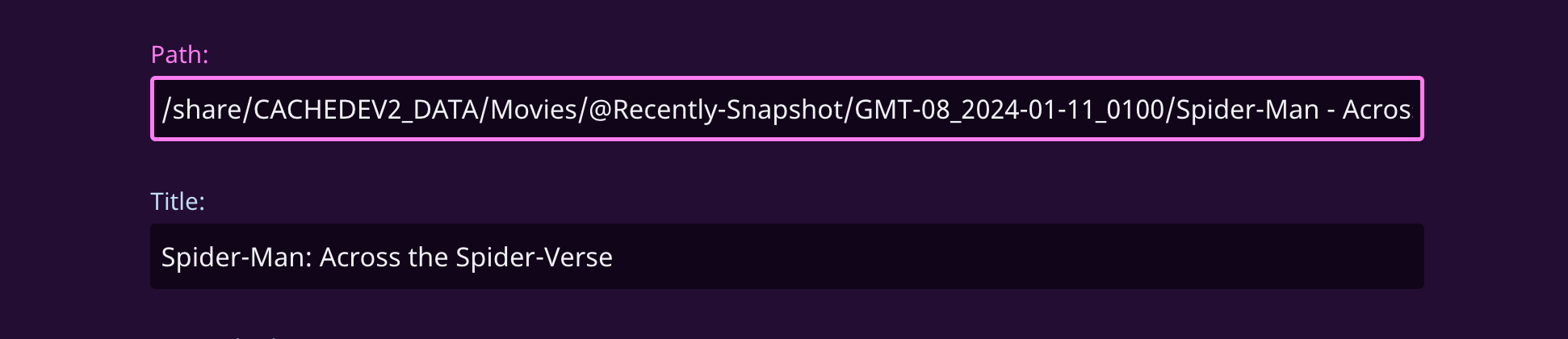

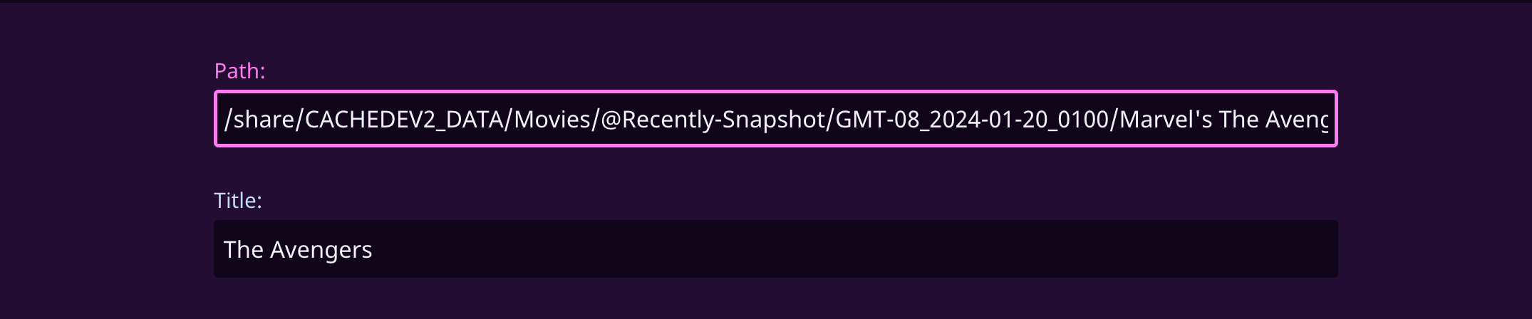

    Hey TMSRXZAR -

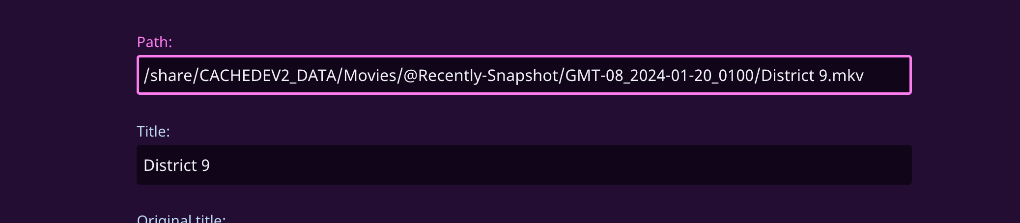

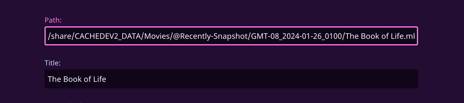

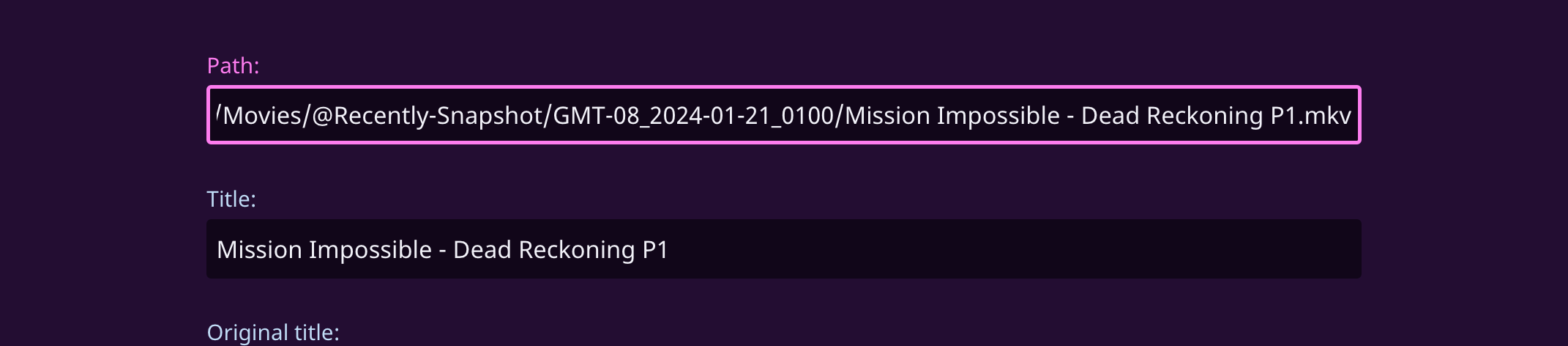

    I am just adding a new response since last night. Something really weird happened over night. I made screen shots of the movie paths that were not duplicating to compare against some that are. I personally don't see a huge difference but the pathway doesn't look like the one you listed.   The weird part is that over night those movies disappeared from existence. They are missing from my Jellyfin que and ALSO from my Qnap.  I know the Qnap is not something for this forum. I'm just saying it because it's bizarre. The MKVs and all the metadata files are gone from my main folder and the snapshots the Qnap took. I'm just baffled now. Now I'm really out of my depth here and grasping at straws but the log from last night looks weird to me. Without knowing how to read this thing at all it kinda looks like someone was watching Pirates of Caribbean last night at a time no one was up watching TV. Is it possible my system is hacked?

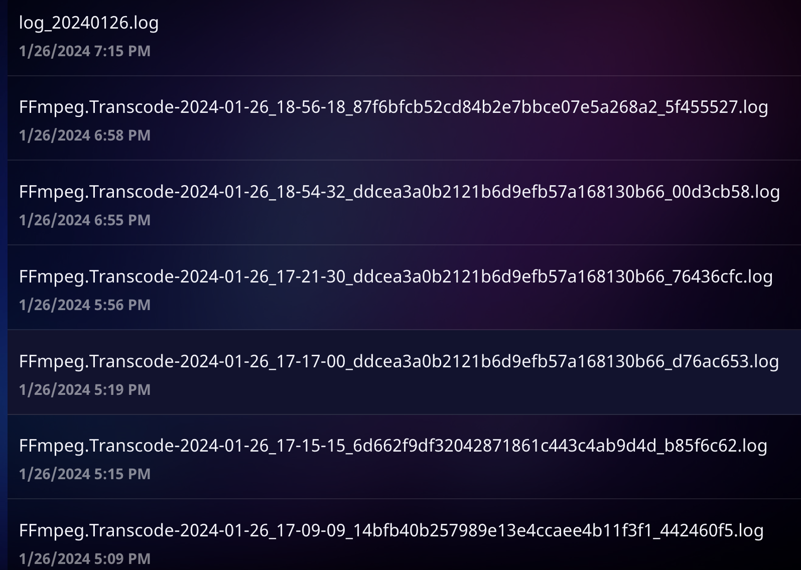

    I'm attaching the screenshots and a log from last night.
    SO for reference  - Avengers, District 9 & Spiderman where the ones NOT duplicating and Mission Impossible, Book of Life & Lego Movie are ones that ARE duplicating.
    .pdf   log.pdf (Size: 54.35 KB / Downloads: 110)

    2024-01-27, 08:16 PM (This post was last modified: 2024-01-27, 08:18 PM by Efficient_Good_5784. Edited 2 times in total.)
    Looks like the paths lead to a snapshot location. Don't link to snapshots, link to the actual media.
    Snapshots are meant to disappear after a set amount of time (if they're not set to be permanent).
    Also, I'm assuming that you have a snapshot task that runs at least daily. This could explain the duplicate media.
    Each time a new snapshot is taken of your media, that snapshot appears as new media to Jellyfin, so it gets scanned into your library and will show as duplicates.
    The old snapshots that get deleted will remove media from your Jellyfin server as well.
    I'm not familiar with how QNAP handles its file paths or how you're running Jellyfin, but this should be fixed by changing the path to the non-snapshot folder location of the media.
    The movies/shows that disappeared from your Jellyfin library should still be on your NAS because it looks like the snapshots are the ones being removed, not the media. So don't worry.
    I suggest you look up tutorials online on what snapshots are, how they work, and why they exist.

    2024-01-27, 08:17 PM
    yea looks like it's down to configuration on QNAP, try disabling snapshots https://www.qnap.com/en/how-to/faq/artic...hot-folder
    pirates looks like it was scanned after qnap touched it, assuming on a schedule or something for snapshots
    duplicates are likely because qnap is touching the files too, moving them into snapshot or however that system works (no clue)

    the existence of FFMPEG logs indicates transcoding is occurring when playing things on your client, make sure you have setup hardware acceleration for transcoding *if available
    documentation for hardware on other systems is all that's available, for QNAP you will need their forum https://jellyfin.org/docs/general/admini...celeration
    that should aid in the system being slow
    if concerned that someone else is connecting it should go without saying that you should check the relevant logs and change all system passwords

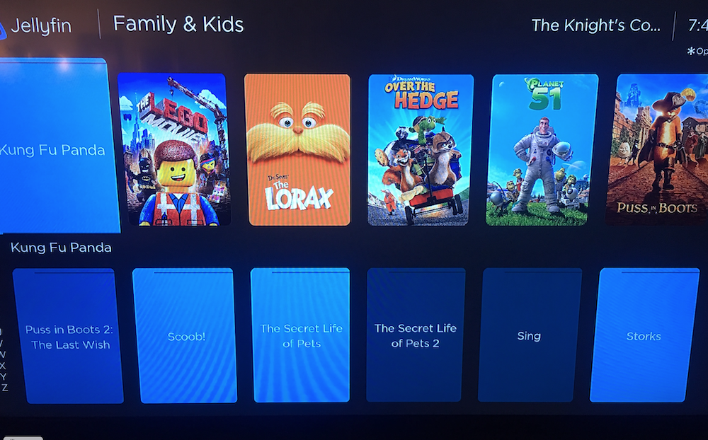

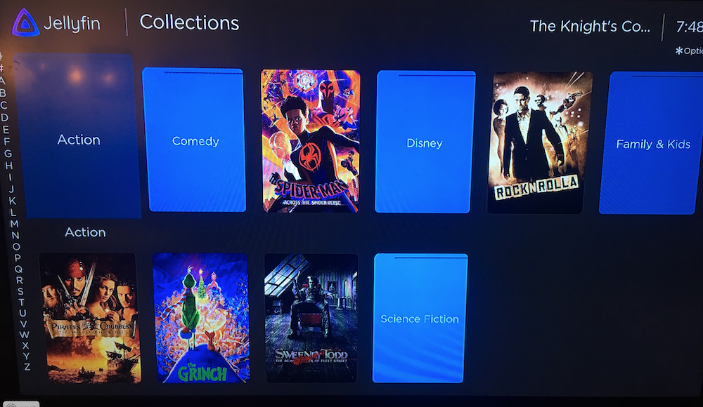

    "The thing that is really a pain in the butt though is the movie poster and collection images not loading." ... "on Roku"
    that *shouldn't be due to QNAP, even a potato can serve images and you say they work fine in the browser
    (acceleration has nothing to do with the images, only playback)
    it is potentially to do with how things kept getting moved around, i suppose it's possible Roku cached them

    Well I tried both of those things and it didn't change the problem. I'm really stumped. Although it really wouldn't take much to do that as calling me a novice at this would be super generous. I've been googling around (don't worry I'm using protection) and trying to find any other forum threads that might help. So far I've found a handful including other posts on here but nobody seems to have fixed this issue. It's impossible for to even say if it's the "same" problem. Could be similar symptoms / differnt cause. But everything I've seen that is within my understanding I've tried to no avail. The couple of time I've seem someone say something worked and I tried it but it didn't work for me. I'm thinking it has to be something with how Roku and Jellyfin are talking to each other since this isn't happening on my computer.
    So I'll throw the ball back in your court but I know you're kind of at the end of options here so I'm not expecting much.
