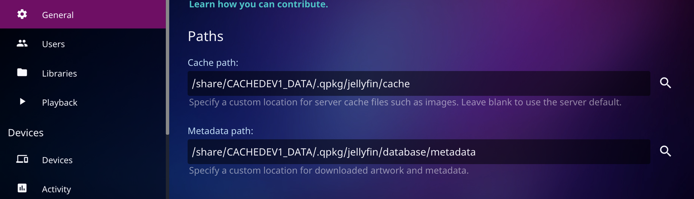

    With that said -  I am home now I checking out my system. I pulled up the log window but there many to pick from that seem to run multiple times a day. I don't know if that's normal or not. *shrugs*  I opened a couple and they are massive. Should I just copy and paste the whole thing into a response? If you see a particular date please let me know and I'll do that one.
    I'm also going to put in two shots of the movies pathway and the metadata pathways.

    I am just adding a new response since last night. Something really weird happened over night. I made screen shots of the movie paths that were not duplicating to compare against some that are. I personally don't see a huge difference but the pathway doesn't look like the one you listed.   The weird part is that over night those movies disappeared from existence. They are missing from my Jellyfin que and ALSO from my Qnap.  I know the Qnap is not something for this forum. I'm just saying it because it's bizarre. The MKVs and all the metadata files are gone from my main folder and the snapshots the Qnap took. I'm just baffled now. Now I'm really out of my depth here and grasping at straws but the log from last night looks weird to me. Without knowing how to read this thing at all it kinda looks like someone was watching Pirates of Caribbean last night at a time no one was up watching TV. Is it possible my system is hacked?
    I'm attaching the screenshots and a log from last night.
    SO for reference  - Avengers, District 9 & Spiderman where the ones NOT duplicating and Mission Impossible, Book of Life & Lego Movie are ones that ARE duplicating.

    Looks like the paths lead to a snapshot location. Don't link to snapshots, link to the actual media.
    Snapshots are meant to disappear after a set amount of time (if they're not set to be permanent).
    Also, I'm assuming that you have a snapshot task that runs at least daily. This could explain the duplicate media.
    Each time a new snapshot is taken of your media, that snapshot appears as new media to Jellyfin, so it gets scanned into your library and will show as duplicates.
    The old snapshots that get deleted will remove media from your Jellyfin server as well.
    I'm not familiar with how QNAP handles its file paths or how you're running Jellyfin, but this should be fixed by changing the path to the non-snapshot folder location of the media.
    The movies/shows that disappeared from your Jellyfin library should still be on your NAS because it looks like the snapshots are the ones being removed, not the media. So don't worry.
    I suggest you look up tutorials online on what snapshots are, how they work, and why they exist.

    yea looks like it's down to configuration on QNAP, try disabling snapshots https://www.qnap.com/en/how-to/faq/artic...hot-folder
    pirates looks like it was scanned after qnap touched it, assuming on a schedule or something for snapshots
    duplicates are likely because qnap is touching the files too, moving them into snapshot or however that system works (no clue)
